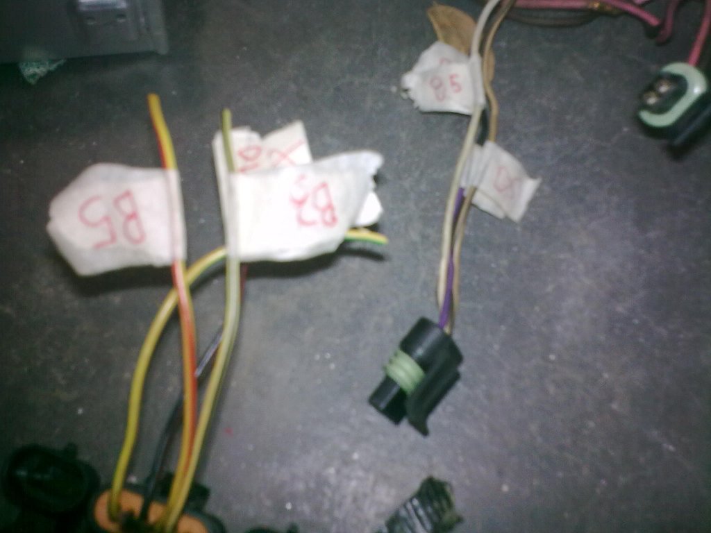

iam know going to add the DIS (d1927a) module to the camira loom.
using the camira wiring diagram i have marked the wires which are required - D4,D5,B3,B5
and using the wiring diagram posted previously on this thread i have marked the wires on the DIS module plug.
the wires (d4,d5 ect..) on the camira loom go to the camira ignition module. so i basically need to cut the plug of and join the matchin wires to each other.
just to triple check is this what needs to be done? the pictures below show what i mean...
also, when the DIS coipacks are being used, the camira coil pack is obviusly not needed, so do i take these wires (from camira ignition module to coil pack and from coil pack to ecu) out of the loom altogether?
sorry if i sound a little simple :mrgreen: but im new to EFI and would rather not have to go buy another camira loom....
join them like this?
is this what needs to happen?
Re: Delco DIS On Non DIS Enigine
Yeah just connect the EST of the module to the EST wire of the camira loom, Ref to ref, bypass to bypass etc etc. Leave a small amount of cable attached to the camira plugs and you can alway re-join if needed.
