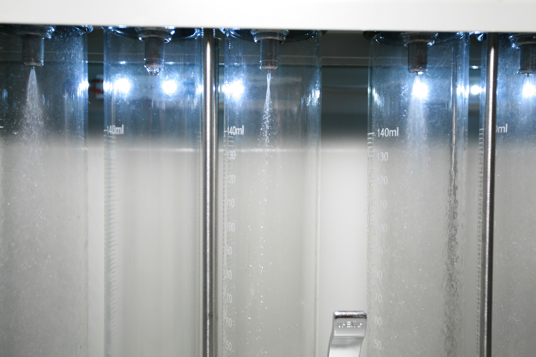

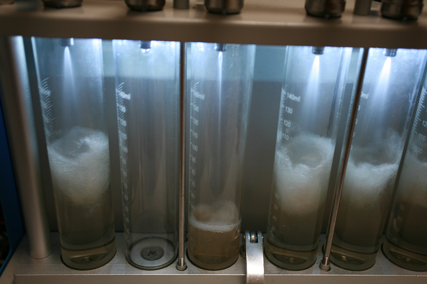

Posts: 5630
Re: Injector Flow Testing Data
i reverse flushed the 60's out the 202 a few weeks ago were full of mettellic looking shit off the fuel pump brushes made it right through the fuel filter
this is why I like to regularly remove my plugs and see that they are all similar colour! can tell you what the wideband can't!
Posts: 4811
yeh it's amazing what rips through them

Stupid question time but how do you reverse flush the injectors ?
Posts: 4811
not stupid at all, depending on injector type i have adapters to mount them in backwards. Can take a pic if interested.
