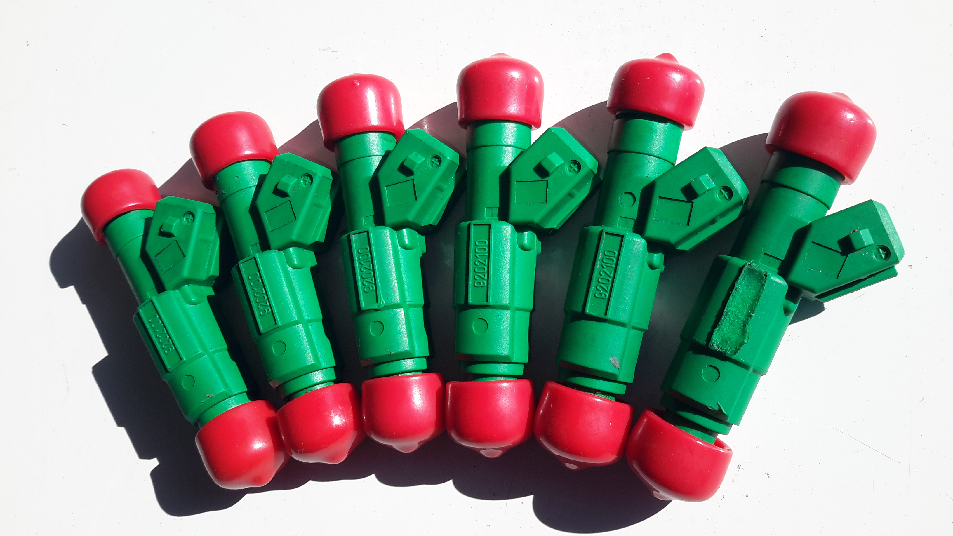

Digging your thread up as it seems likely I would get an answer here.
A few years ago (maybe 4-5 or 6) I bought these injectors off a guy from Qld.
I am really bad for buying stuff that I don't need to use right then & there.

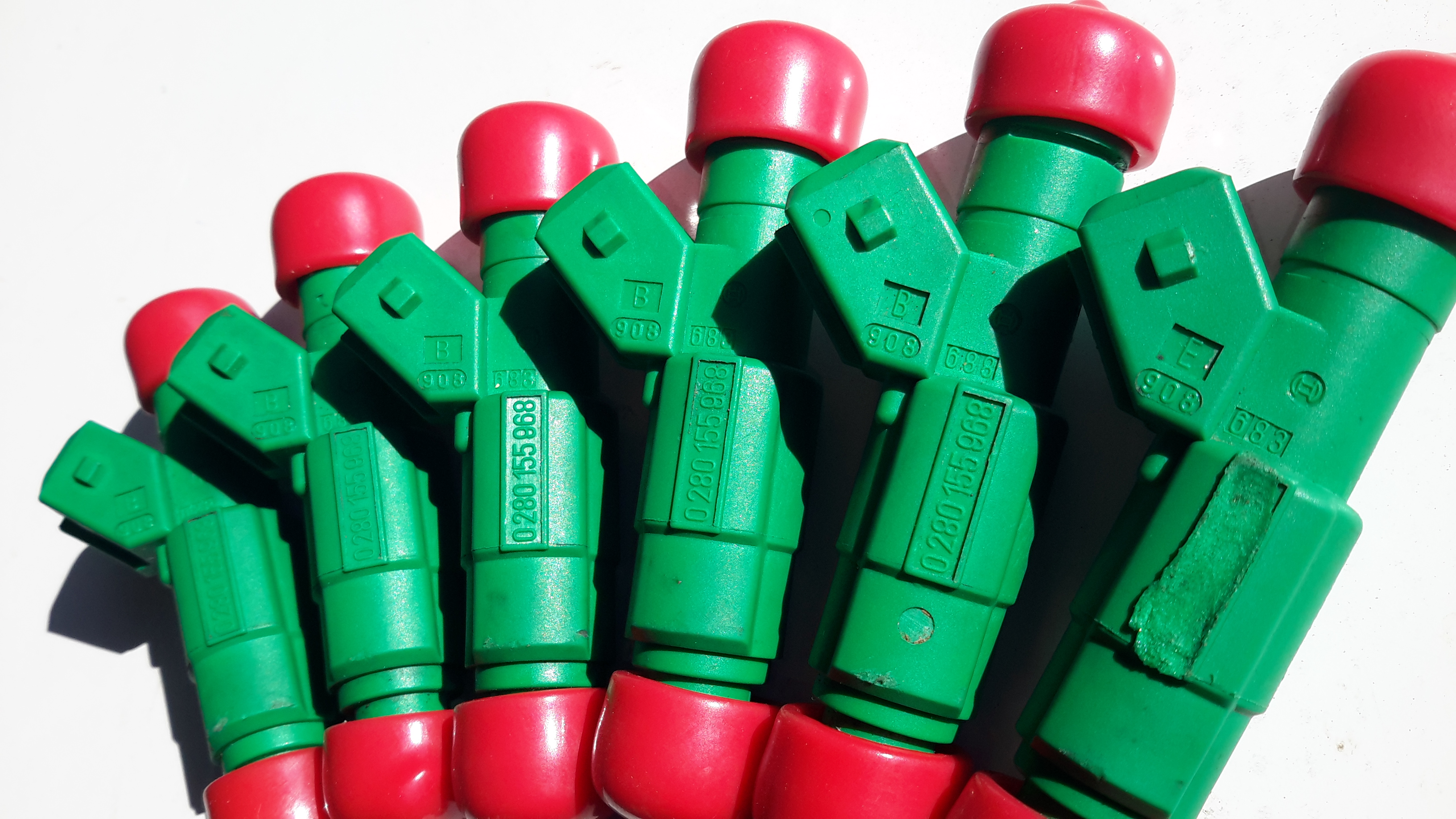

So unwrapping these supposedly Bosch 42lb green giants yesterday I notice one is different to the rest (set of 6).
While 5 have numbers each side one has its numbers melted off. At the top they all have a captial letter "B" , where as the suspect one has capital "E".
Have heard that there is fake copies out there, so anyone able to tell if one or all of these injector are fake bosch 42lb .

The 5th one is different too, came from a different moulding machine with the small circles in a different spot. Its pretty suspicious that the part number is melted off the 6th. I'd be interested to see what others think from the above, but i'd definitely be dubious and wanting to flow test them before trying them.

Pretty suspect with numbers melted, no idea really though without testing done

I think they were mainly OEM to some Volvo models, so prob why there not widespread.
