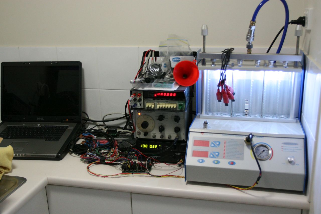

Posts: 4811
Re: Injector Flow Testing Data
Got the flow bench and test bed for enhanced tidied up, shifted to another room with extraction fan, just need to mount the jimstim and other gear in a box and it'l be all tidy then, bought a cheap flow machine which i have gutted, installed an 044 bosch pump and rigged another circuit up to the front dial so vary the pump speed, then rewired the injector loom into the test bench, wired in an 0-80psi pressure sensor for fuel pressure into spare pcm input, all good to go.
Posts: 2606
Is that your kitchen?....
Posts: 4811
haha, no it's an extra room we built in the garage, has dryer and washer in it, but has extraction fan in it also.
