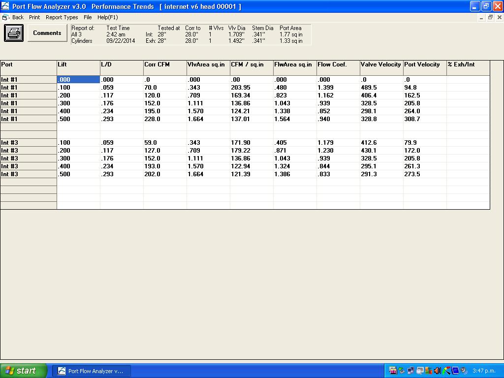

on other topic it seems maybe the bench aint too bad when i scaled the readings of a ported head port i flowed to suit maf error seems to be following the near identical flow curve to ported head data i have
getting excited now see image attached port 1 is my port ive been slugging away at v's flow data from usa in port 3
