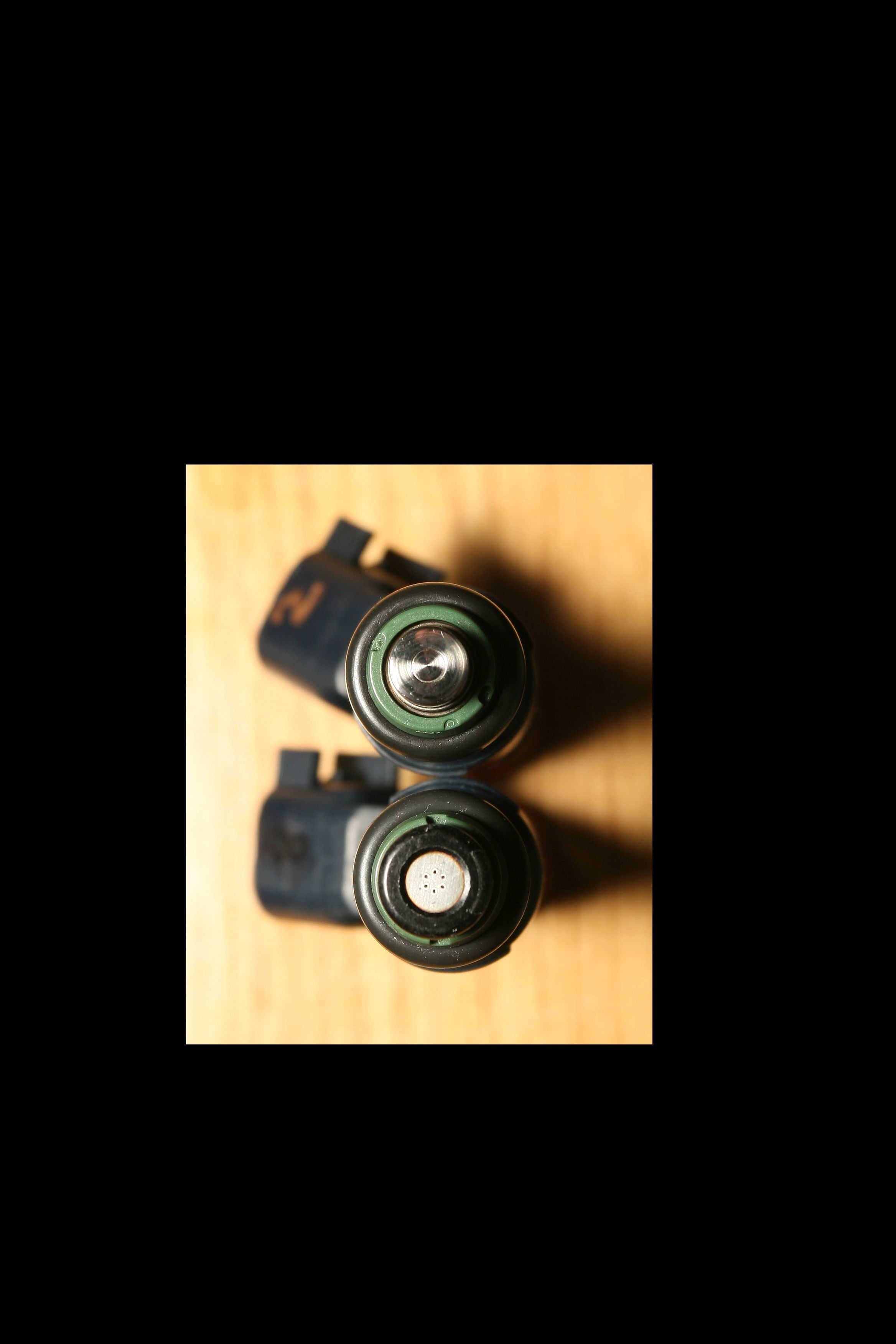

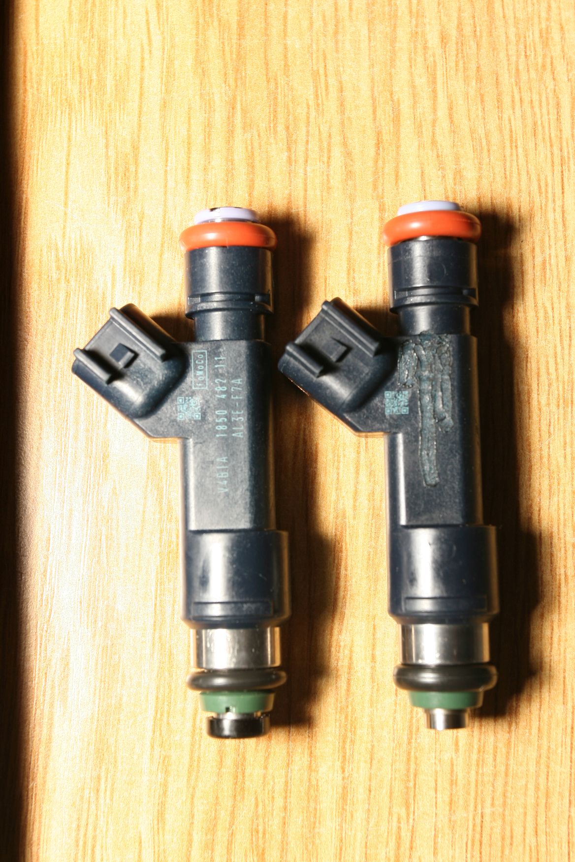

i had a guy contact me about some injectors he had trouble getting to work, he apparently bought them here.
http://www.ebay.com.au/itm/Injectors-90 ... 1097345150
They wern't the bosch injectors in their photo or the denso's they claimed in the description but these.

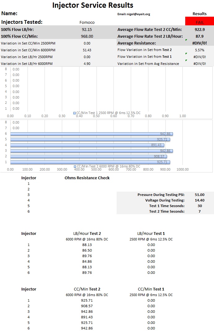

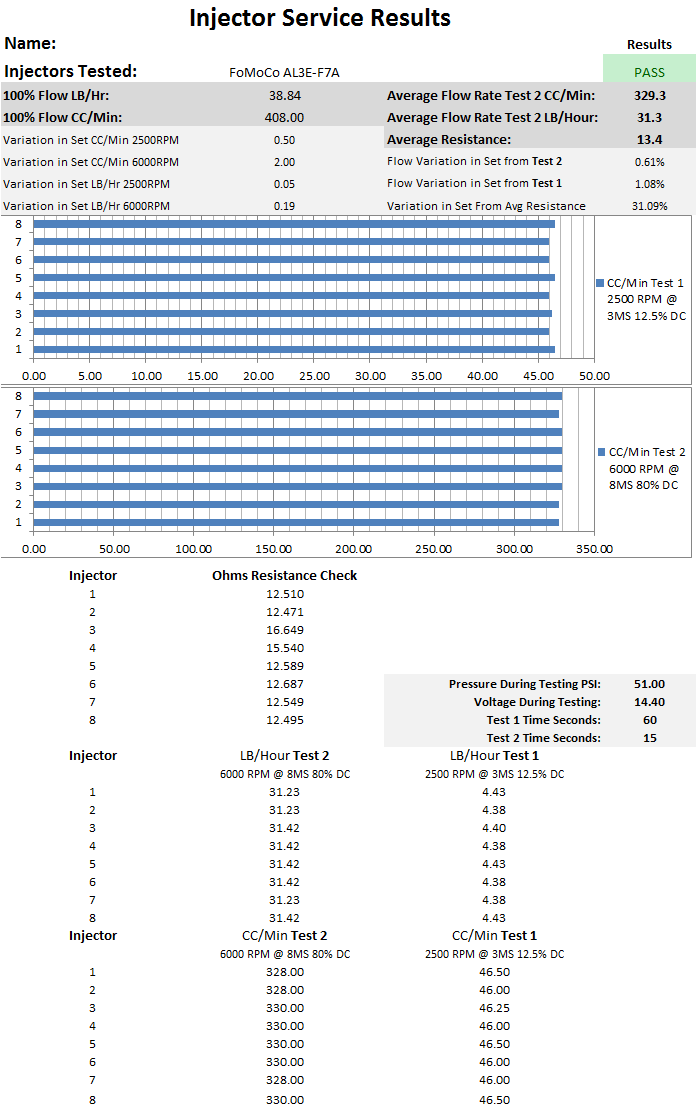

No 2 guess's which one is the genuine, well both of them, but as you can see the lid is popped off the Claimed 90LB ones and the part numbers etc melted to hide where they come from. The flow test is below, these are normally 39LB FoMoCo injectors which are Ford OEM in F Trucks 2005 and newer. They dont exactly spray well with the caps removed or flow match either.
Here is where i buy mine, $160 for 8 genuine FoMoCo, $340 cheaper, i have bought about 5 sets now and all verified like the good flowtest above. I also have deadtime data if anyone wants it for personal use.

Here's the normal flow sheet Here's the modded ones flow test sheet

yeh the same deal has been happening since fuel injectors came into existance, even back to the VN's with unscrewing the cap and removing the screens to get more flow from the stock injectors. I dont have a problem with people doing these things but lying to the customers and ripping them off is just plain bad and to make matters worse it's so hard or next to impossible for the end user to verify anything these days. Mostly the reason why i built my own test rig so i know im generating my own data and test my own product.
ralcool, yeh ive had those in my VS V6 N/A doing testing for quite some time, they are a nice injector and id say for the money there a very very good alternative to the very expensive EV14 Bosch injectors, like what ID uses's, if 39LB is enough then id recommend them, i have put them in a few L67's now and run well, the only downside is you need to fit EV6 to EV1 adapters but there cheap. Ive had no problems getting a set to flow match under 1% using 2 sets.
