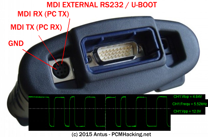

This is a strip down and info dump about a GM MDI interface purchased from ali express.
Note that this is just fun and games and this post is for the hackers out there (both of these definitions of hacker...) http://en.wikipedia.org/wiki/Hacker_%28 ... culture%29 http://en.wikipedia.org/wiki/Hacker_%28hobbyist%29 :lol:
It turns out these interfaces run Linux which makes them very hackable. Should be lots of good times in the future.
Note that it is very easy to damage or destroy your MDI when using these tools. Use this information and shell or u-boot access at your own risk.
The main board includes an sdcard, which includes a linux filesystem. At run time this mounts under /usr/local/. Once the filesystem is mounted you can enter bin and rename telnetd.sh-disable to telnetd.sh. Now reboot and check your MDIs IP address, and telnet in. You will be dumped straight to a root prompt. Set a nicer prompt like this:

So, lets go deeper. Its got U-Boot, and I want in. I managed to trace the data across the board, and find it on the mini din 8 connector on the outside of the case labeled "RS232 (for future use)". I guess this means they can reflash it from factory without opening the case. I tested with the scope and found tx and rx pins. You can make up a connector from your pc connecting to these pins:
Once done, set your terminal app to 38400,8,n,1 and click reset.
