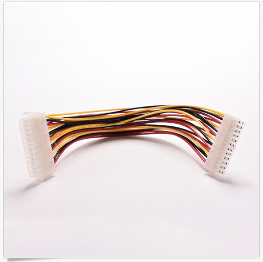

I believe its the atx connector as it makes it easy for people to buy a atx cable off ebay, eg:
I personally know I'd prefer that option than to have to crimp them all
but I guess if you want to do your own wires and happy to crimp it then you could probably get the plug and pins all separately.

This exactly. Initially the module did use a 24 pin automotive connector but its time consuming to terminate, and you cant expect an end user to buy a (often) multi hundred dollar crimper to DIY it. A major consideration is not everyone has the same skill set and toolbox either, some like to DIY everything as its all in the fine details of a build and others prefer just twist joining wires and ripping skids. Unless more than 24 pins are needed the ATX connector will be staying, its easy to source, it works for those that just want to wire it in and its easy and cheap for those that want to buy pins and a crimper if they wanted a custom terminated loom.Holden202T wrote:I believe its the atx connector as it makes it easy for people to buy a atx cable off ebay, eg:
