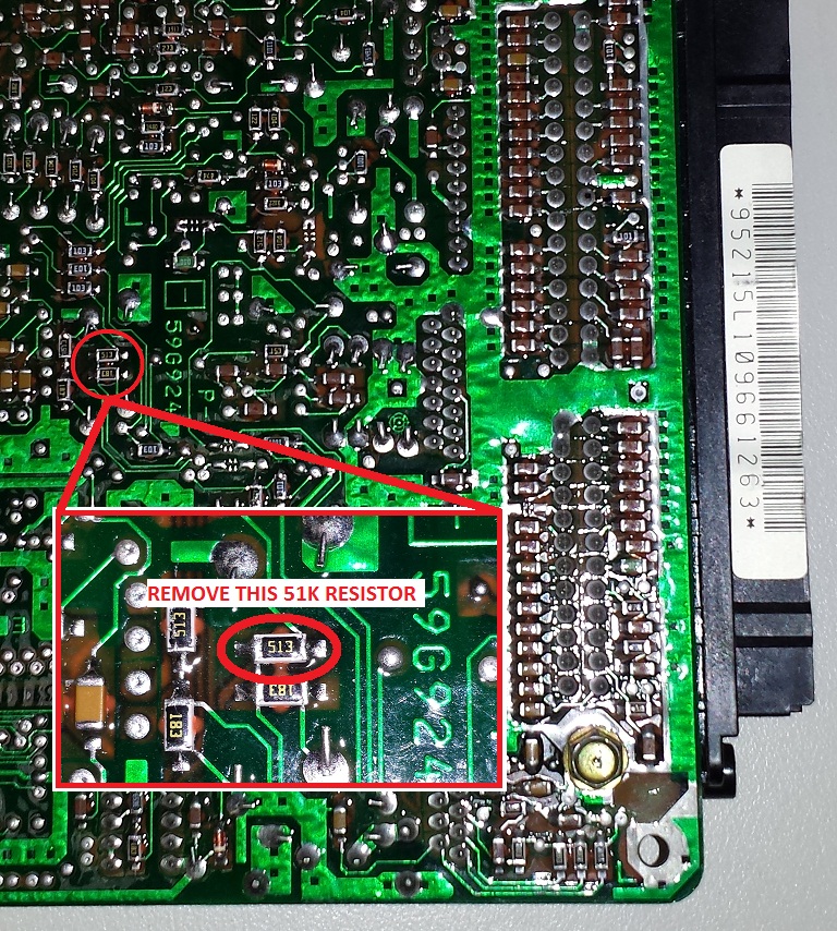

For those that are having offset issues with wideband readings on pin D8 there is a resistor that can be removed from the ECU. Removing it will not cause a problem if you dont need to or if the offset is from poor grounding, but for widebands that are using PWM DAC analog outputs it will remove or greatly reduce the AFR offset.
Most new widebands use a PWM DAC output as its far cheaper to implement (cost is one resistor and a capacitor using a spare PWM output from the controller's processor), some known models using this type of output are...
- Innovate MTX-L
- Innovate LC2
- 14point7 Spartan, SLC OEM/EvK
Here is what needs to be removed, it is a 51K resistor...
808 Pin D8 Mod For Wideband.jpg (448.66 KiB) Viewed 12185 times
Known models using a proper analog DAC which should not have a problem are..
- Innovate LM1
- Innovate LC1
If you are using one of these but are seeing an AFR offset then the problem is likely poor grounding.

You can add 14point7's SLC OEM/EvK to the PWM DAC list.
ejukated
Posts: 425
Re: OSE 12P V112
Post by ejukated »
What does the resistor actually do?
Re: OSE 12P V112
festy wrote:You can add 14point7's SLC OEM/EvK to the PWM DAC list.
Thanks, added them.
ejukated wrote:What does the resistor actually do?
Its a pull down resistor.
