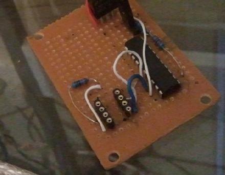

The1 wrote: This is what i made up
That adapter is almost as complex as my whole programmer ;)
