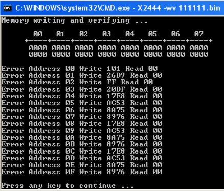

I just used the dos program x2444 see blow, any suggestions?
festy
Posts: 1039
cars: Alfa Romeos
Location: Narellan, NSW
Post by festy »
That was written for a specific programming interface, not the programmer you have.
what happens when you try and write with ponyprog?

I was using the programmer hardware for that program (ie I built the circuit in the PDF for the exe) The thing I like about this hardware is it has an LED so you can see when the serial port is communicating with it.
Posts: 9020
It looks old enough that you might need a real (and old) dos computer, not a windows dos shell to make it work.
