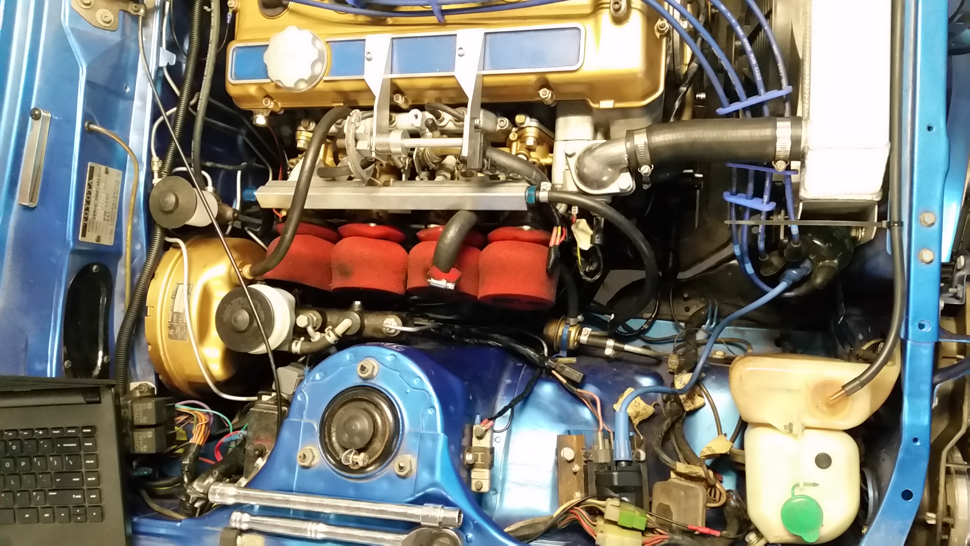

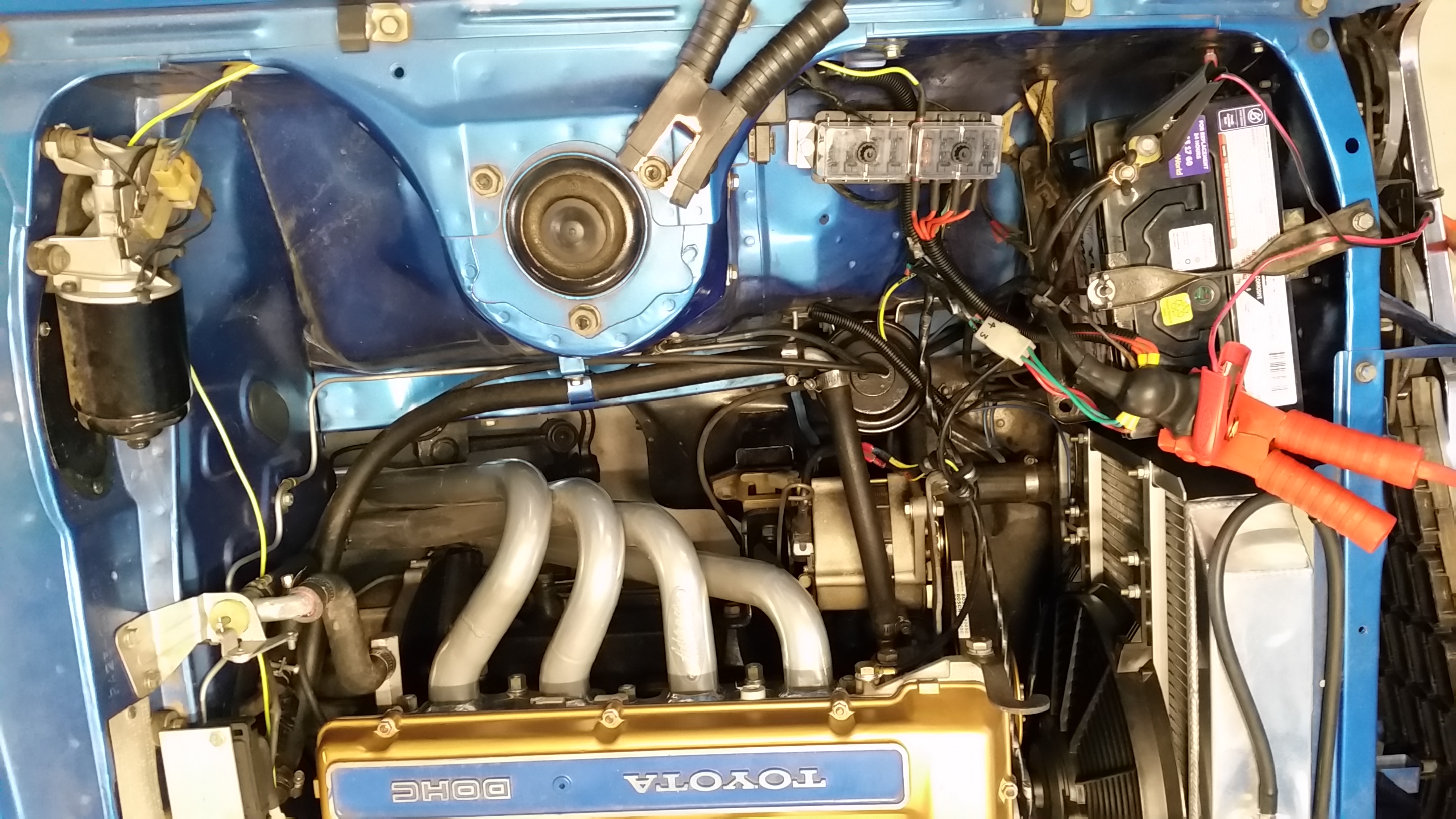

Engine bay drivers
Engine bay drivers
Engine bay passenger
The wiring that runs near the engine loom in the engine bay includes:
Lighting, wiper washer, radio 12v supply only, wiring now redundant after the engine conversion.
The ecm sits under the fuse box, so it could get interference from anything in the car at that point.
The problem exists with radio on and off. The antenna cable does pass by the ECM but is not near the distributor sensor or ignition components other than the kill switch.

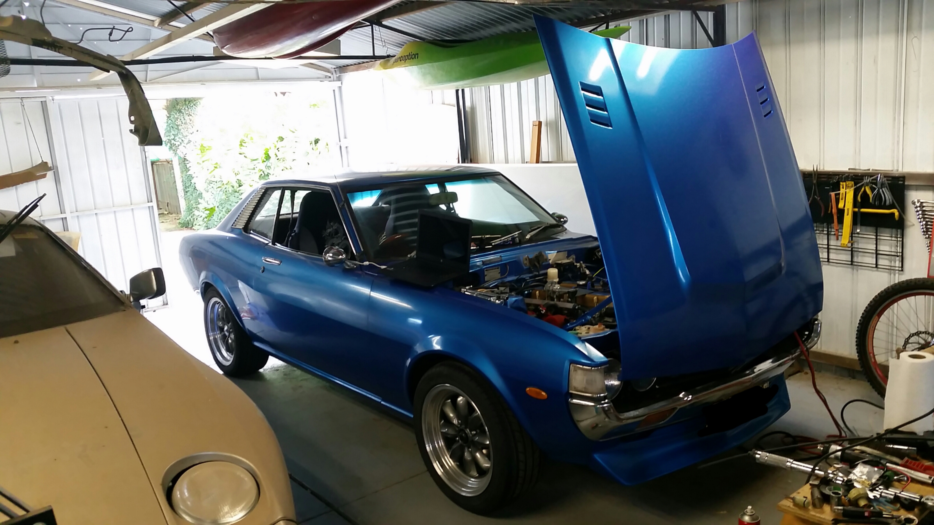

Geez, neat looking, I think we need a full photo of this :thumbup:
