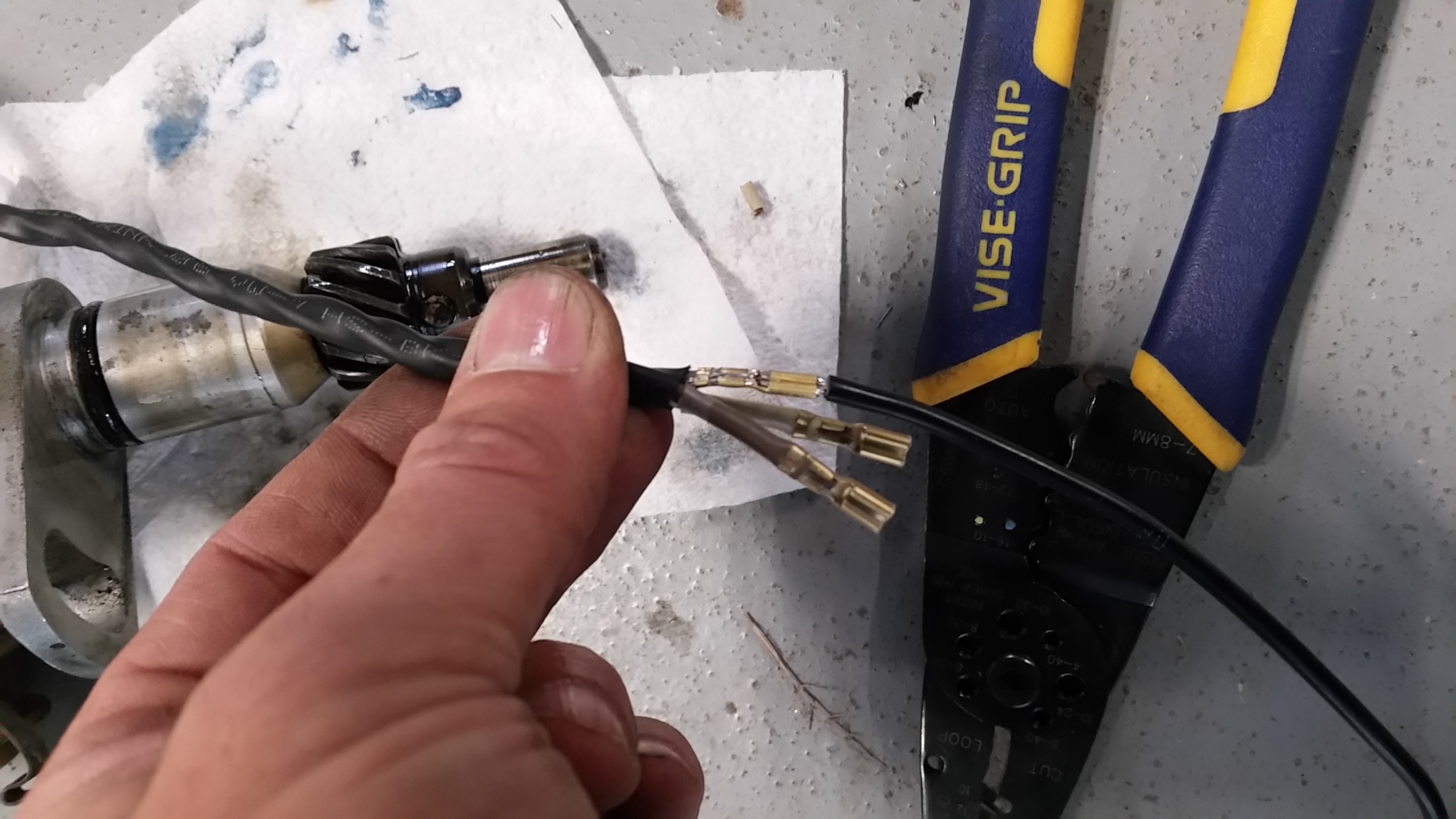

Is that proper shielded twin conductor cable, or was that a DIY job?
Re: Toyota 18R-G (808, NVRAM, USB) - died, help please
DIY job.
Sensor wire pair twisted with uninsulated copper cores. Heatshrink over the top.
Next mini project will be to do something similar with an ABS sensor.

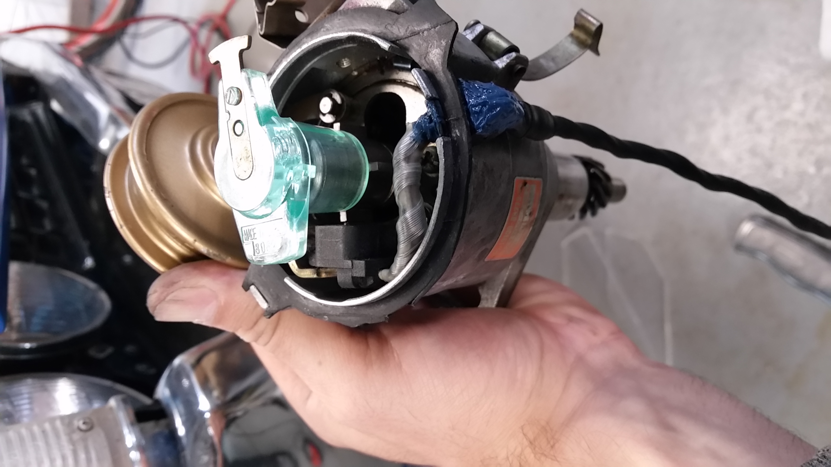

Do you have a normal bakelite rotor you can try in place of the see through one

I'm not sure that will be doing much, the gaps between each turn would need to be just about zero. Jaycar sell a couple of different shielded audio cables by the metre - I think this is one of the types I've used with reluctor sensors in the past with great results.

I do have a normal rotor, which had a smaller tip on it, more like the width of the camira one. I was using that when the problems started. Changing the rotor hasn't made any difference.
I picked up some shielded microphone cable the other day but wasn't too keen to cut my reluctor wires.
How close to the sensor did you start your shielded cable?
Where did you ground the shielding?

Yea I had a problem with the engine just cutting out and it turned out I had to use a shielded wire from the dissy trigger to the Camira module. It fixed my problem but you say your car was running fine before it sat for a while.

Charlescrown - where did you start and finish the shielded wire. Also, where did you ground the shield?
