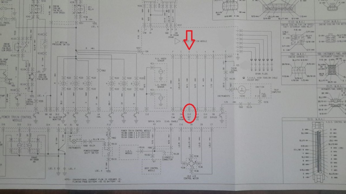

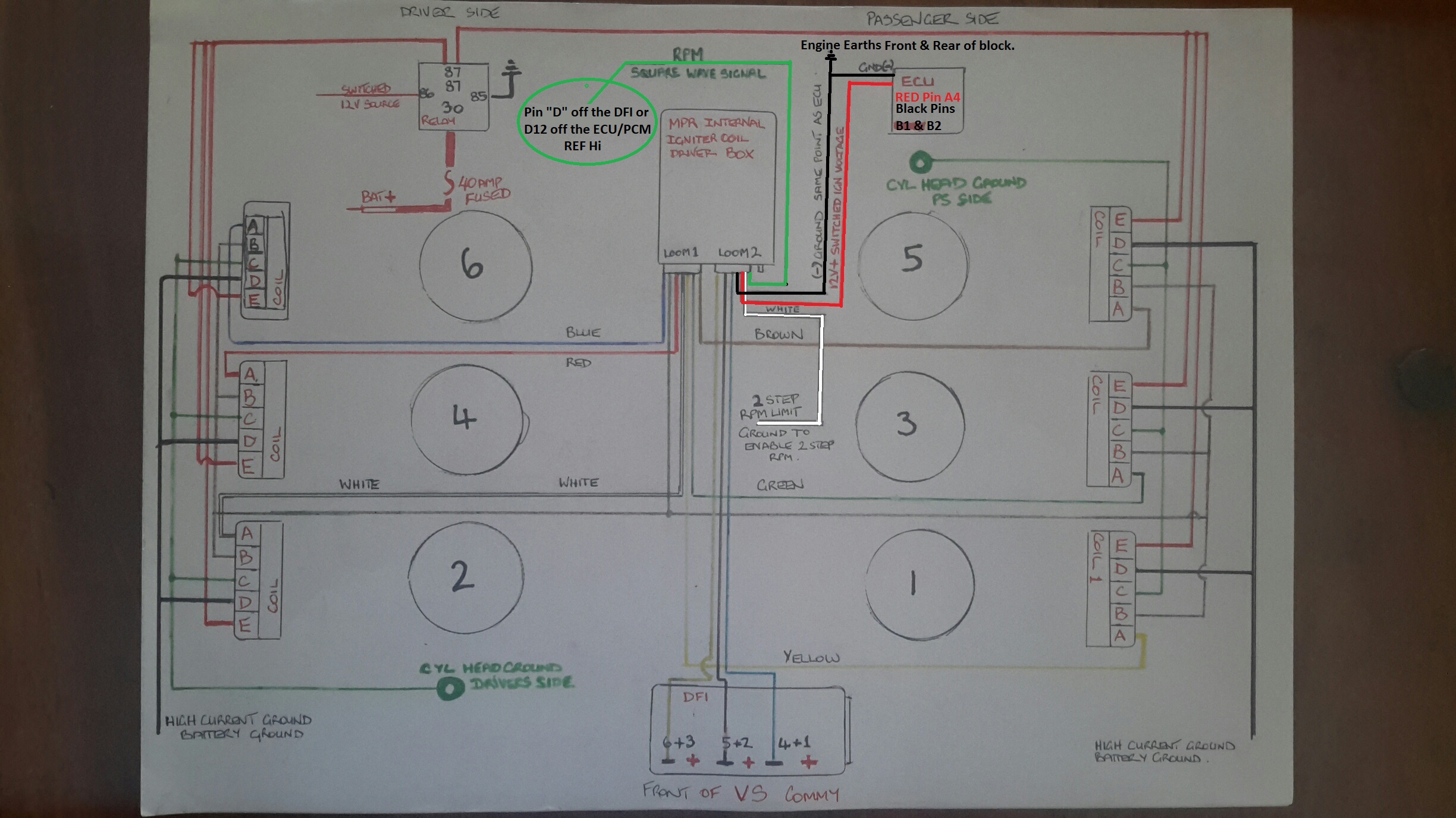

I have been plotting my path for a VS V6 Commy to do the LS1 coil driver conversion. Have not completed as yet but have worked out what I will do.
My RPM reference was going to come from pin "E" on the DFI unit, BUT after the good people on here have informed me that would have been wrong. I have now changed my drawing to show Pin "D" from the DFI to the ECU (D12) to use for the RPM Square wave signal.
I will attached a couple of pics to see if your the same. Although mine set up will use the Smart Coils & not stock LS1 coils.

the coil driver box doco recommends using Reference high - D12 on your diagram, or pin D on the dfi module.

Are you able to explain to me what the REF Hi & REF Lo mean & the difference between them & the Pin E RPM signal please ?
Not being an electrical savvy type I was a bit lost when it said RPM Square wave signal.
Cheers
Deek
- Posts: 5493
Re: Vs l67 with ls1 coil driver box no injector pulse
Ref high is the 5v crank signal to the ecu ref lo is the earth for it pin is is the output to the tacho

Thanks delcowizzid.delcowizzid wrote:Ref high is the 5v crank signal to the ecu, ref lo is the earth for it, pin E is is the output to the tacho
So with this modules instructions asking for a RPM Square wave signal - On an EFI vehicle the Reference signal the ECU uses to determine rpm should be used.
The Pin - "E" Tacho signal is not square wave & is not what the ECU uses ?
Actually now I gather the Pin E RPM Tacho signal comes from the DFI & is not used by the ECU ?
Sorry I know your will be thinking wtf. But just trying to get my head around the hows & whys.
Cheers.
- Posts: 5493
Yes like the instructions for the box say
