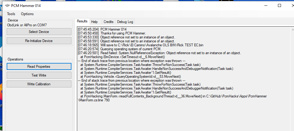

Hello,
I'm having trouble with both PCM Hammer 14 and 15. Please see attached screen shots and debug logs. Seems to be the same problem in both variants of the program. It also does not appear to be a problem with the ELM device because that device is usable by other programs and other Android and Windows devices.
Many thanks,
Rick

That is a Windows Port issue, not a PCM Hammer issue.

I agree, windows is sending an io error back when the app trys to talk to the com port. maybe we could catch the exception and log an error about being unable to open the port, but it wont get it working for you. also, you mention elm device. Note that the original elm and clones cant be used with pcm hammer as they are too limited to do whats needed.

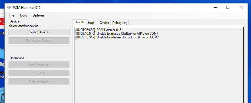

And to get back on track ... This issue is already trapped and handled!
B52Bombardier1's, Debug log is 014, the upper image is 015, the lower image is 014.
Only the log (014) and lower image (014) have the unhandled exception, the upper image (015) shows it is handled!
