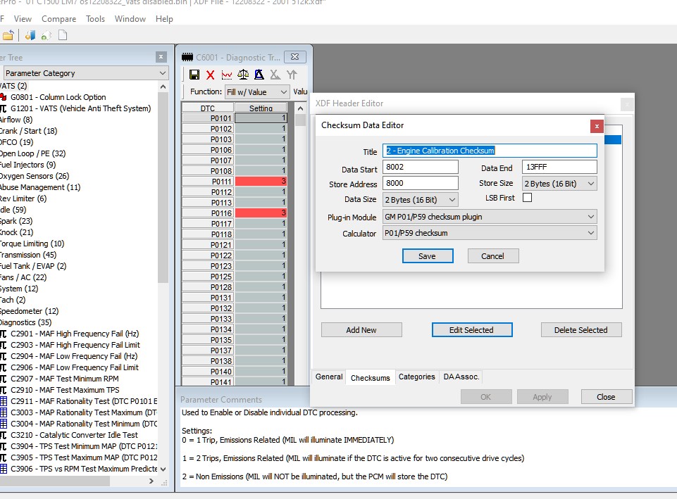

That did crash on me with my checksum dll files until I went into the XDF(view XDF header info) and pointed each segment to my checksum dll.. pic of what I changed is below.
I am guessing here that the xdf you've been using was written for the oldr checksum dll.. Either keep on using that one or change the xdf's to accomodate the other/newer? one..

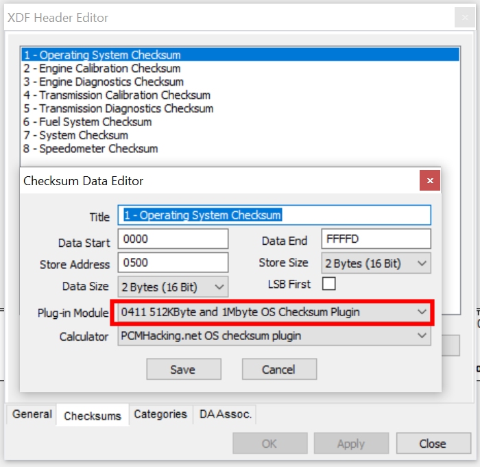

These are the commends in the tunerpro checksum plugin SDK. The shown UUID is the one from LS1 Checksum Plugin v1.1 which did all the good things. The XDF is tied to a particular plugin by matching this UUID. Having several plugins now with various capabilities means its a mess to know which one and XDF is expecting and which one(s) you have.
// Every checksum plug-in needs to have a unique identifier. This identifier allows
// TunerPro to determine if the plug-in has already been loaded. Every time you create
// a new checksum plug-in DLL, you should create a new GUID to uniquely identify it.
#define PLUGIN_GUID     "9A53F577-D1C9-40C6-8691-7A54FA789D3A"
The box in red saves the plugins UUID in to the XDF. So for this checksum to work the matching dll much be available on the system when it loads the XDF. Because you cant see the UUID easily in the XDF or in the DLL it gets hard if your not supplied the XDF with the DLL at the same time, or you dont store them that way in your archives when you need to install to a new pc.
the plugin module name is a UUID internally.jpg (154.26 KiB) Viewed 6383 times
