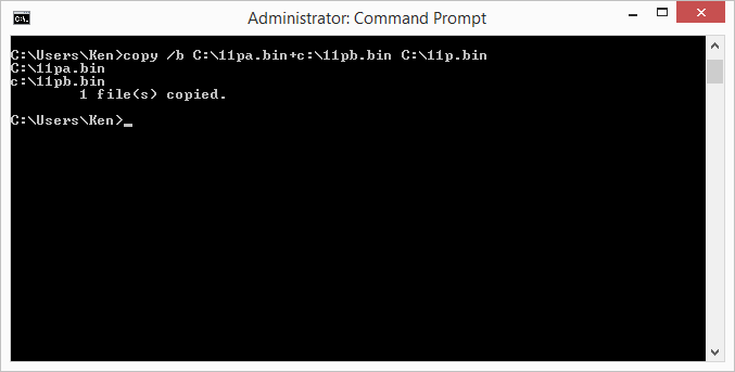

Since not everyone understands the process of offsetting the flashing process to stack using the burner, you can stack two copies together using the windows command prompt /binary switch, then flash the stacked copies to the chip.
Take a copy of the 11p tune, for simplicity place it on your C:\ drive, rename it 11pa, put another copy on C:\ drive, rename it 11pb.
Open your command prompt, type the following in the command prompt window
copy /b C:\11pa.bin+C:\11pb.bin C:\11p.bin
then press the enter key.
If you're successful, you'll see the results shown in the pic I posted below.
You'll now have a stacked copy called 11p.bin that you can directly flash to the chip.
Alternatively, it can be done on any other drive, and change the command to refer that drive instead of C:\ drive.
