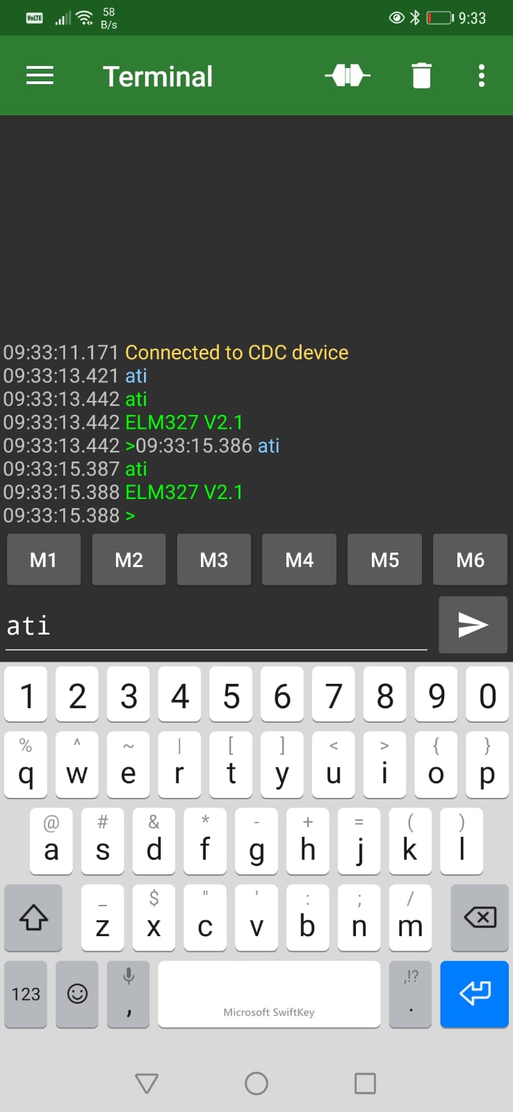

MAUI template app is now also going to support direct USB connection on Android devices!
The default android USB CDC driver works with OBDX devices, this will easily be the fastest option available which we will encourage developers to use.
Unfortunately it is not an option for iPhones, but still pushing forward with solutions there.
