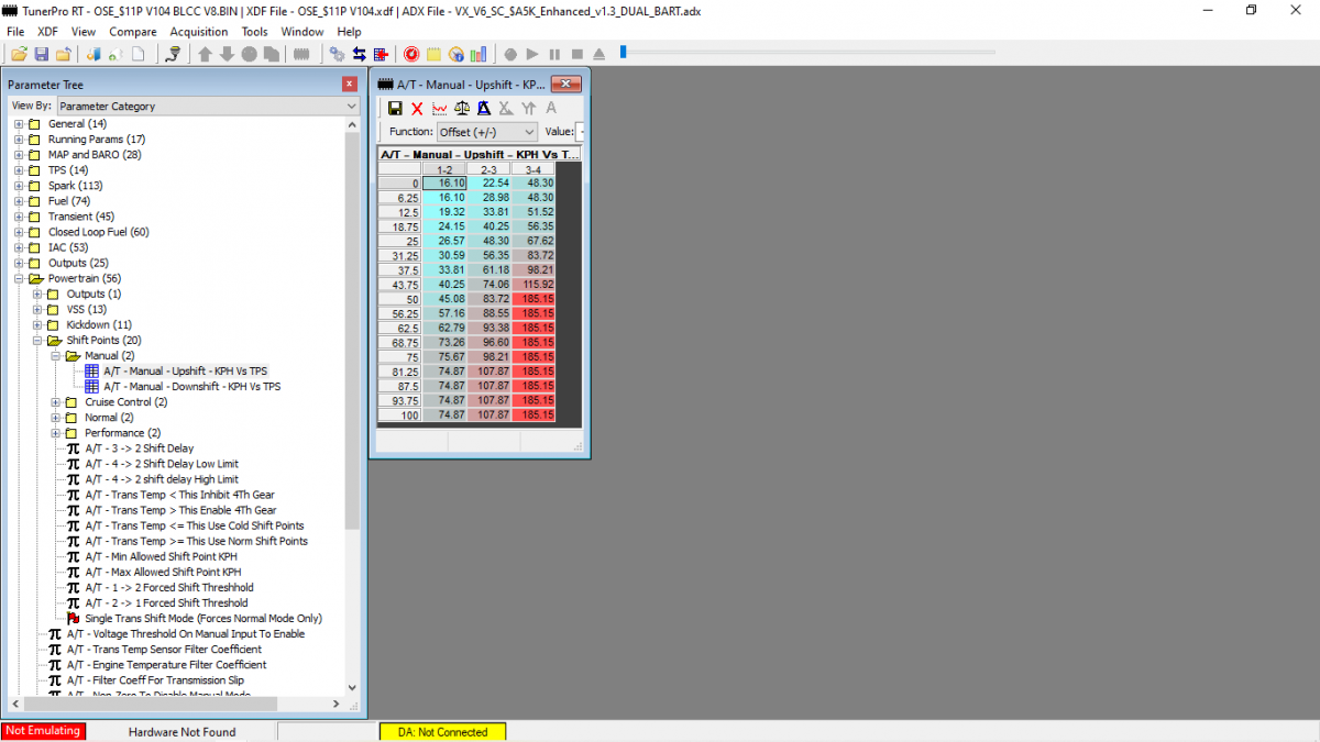

When you move the transmission out of Drive into one of the selected gears ( 1,2 or 3) the trans is now in manual mode so you will need to adjust the manual tables. See
I don't see any reason why leaving the auto in Drive would hurt the transmission.

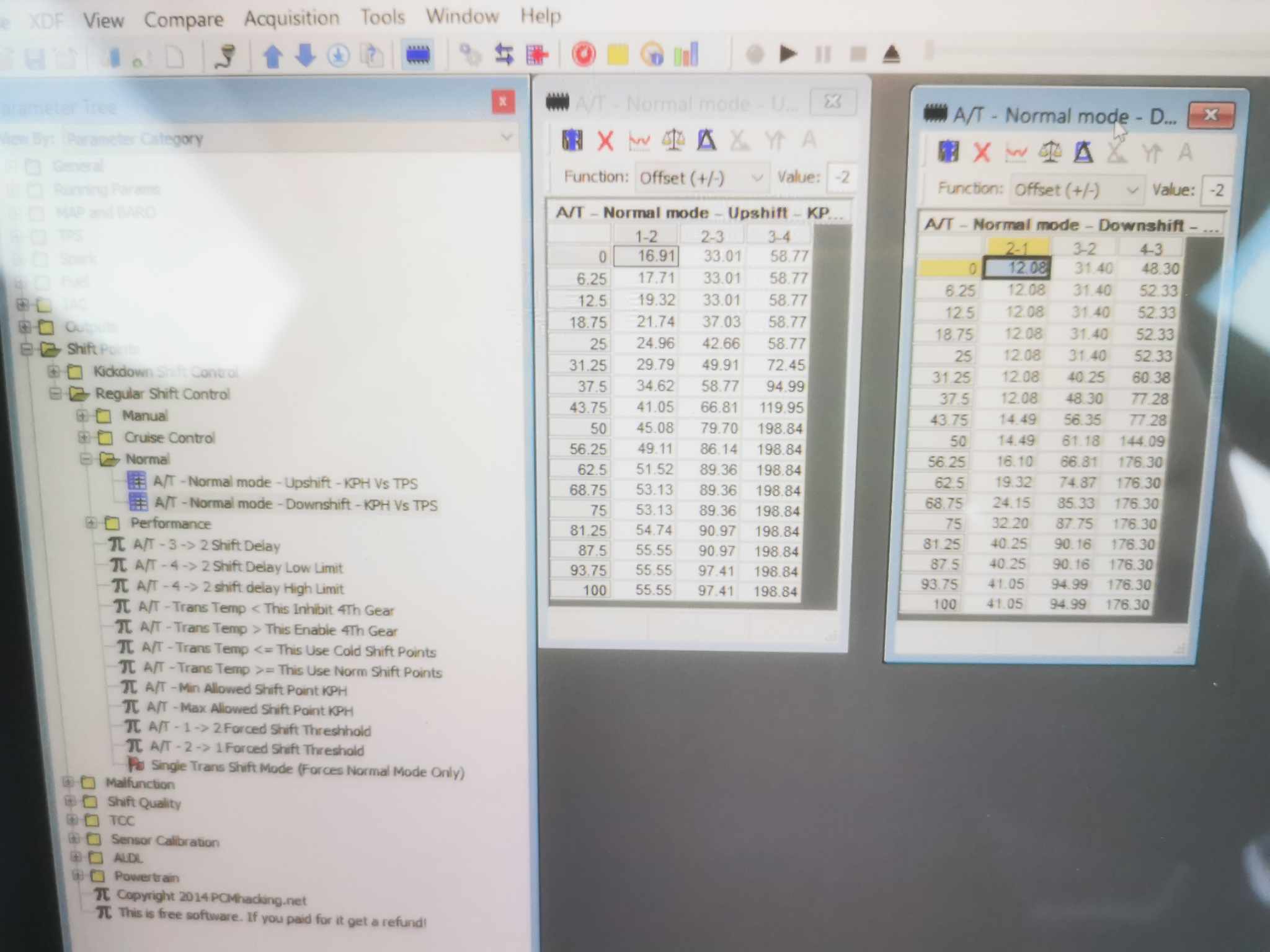

Thanks immortality. These are my values of my tune lol
Can i just put the same values as whats in my Auto shift tables above in here maybe with a couple of kph more on the 80% tps upwards sections and it will get me by ?
Posts: 3426
Re: 11p 4l60e auto tuning help needed
Yeah, start with the same values as in the Normal tables and then modify from there.
Edit: I just checked the V6 tune, it looks like the cruise tables aren't set properly either so if you use cruise control you might want to set those tables up as well. Don't forget to do the down shift tables as well.
