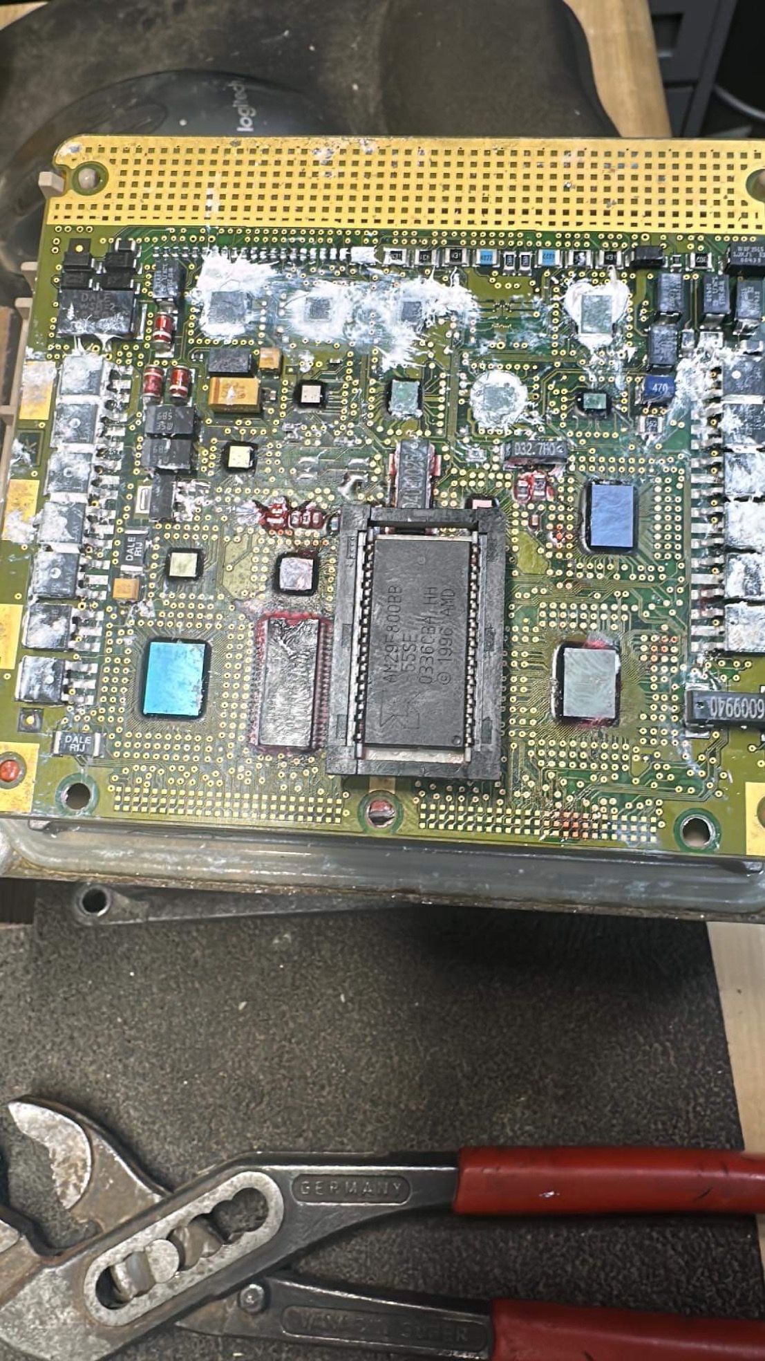

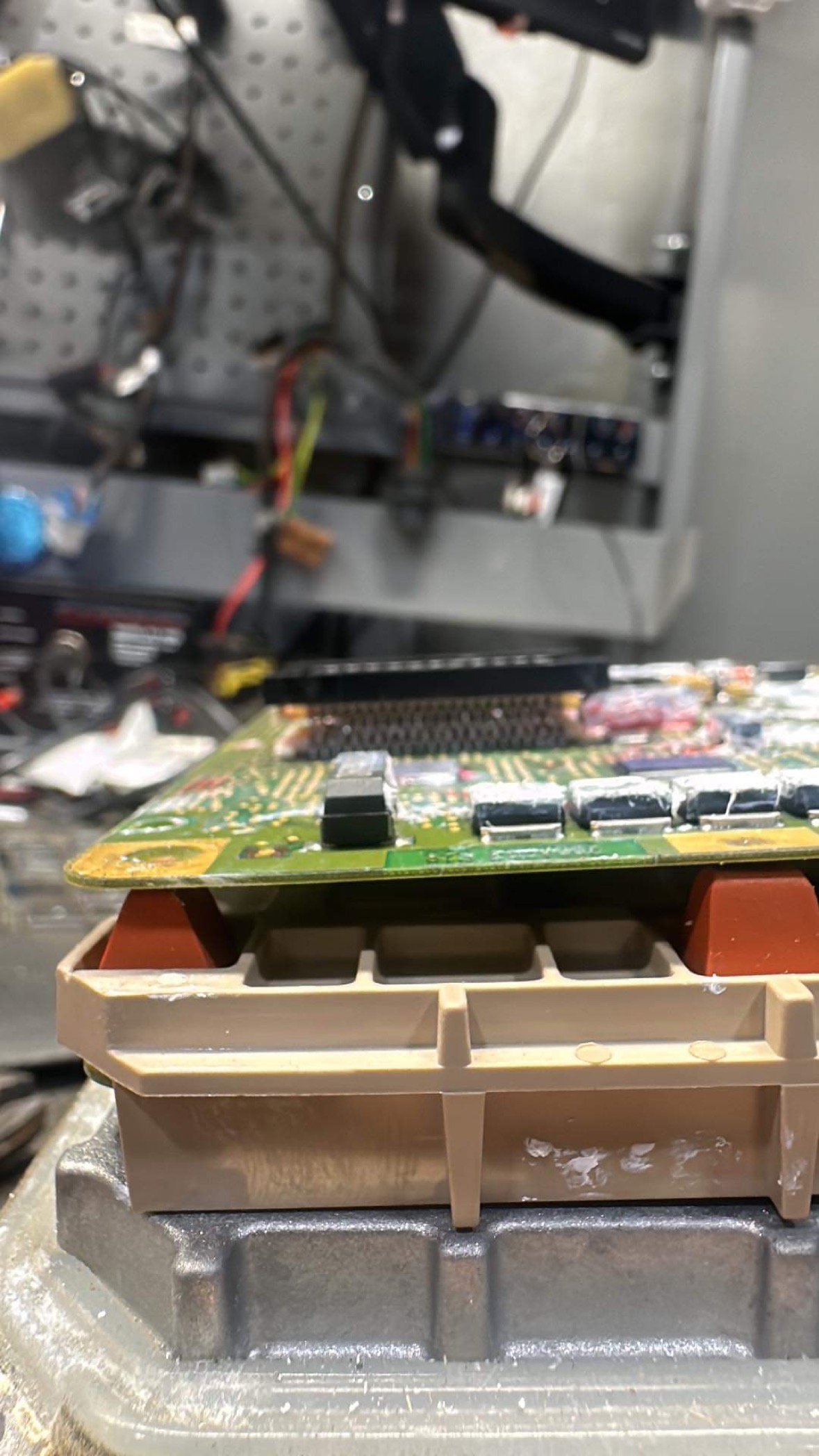

roughneck427
Posts: 51
Joined: Thu Feb 07, 2013 1:49 pm
cars: 2002 Camaro
2008 Pontiac G8
Re: P10 Tuning
Post by roughneck427 »
I cut a window in a case and had to double stack a socket. Antus if you need this I can send it to you if you need a test mule.
Posts: 8253
Re: P10 Tuning
Thanks, but as above we need another developer with interest in adding slave support to go further. Its a hard one, because the code is stored in the cpu and we need to understand and create the mechenism of running code on the slave and using shared memory to get the payload in to the slave's storage. Not impossible, but its next level of complexity and not something we've done before. If we someone did it, it could probably be re used on other pcms with a slave cpu. If someone really needs to do that now they can hook up a usbjtagnt to the slave bdm pins and write it that way without pcmhammer.
