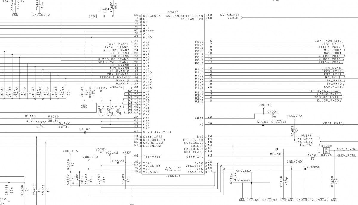

There are no schematics for the ECU, no datasheets for any of the custom Bosch IC's though they're not needed for spark/injector control. Only for the ADC / Knock IC.

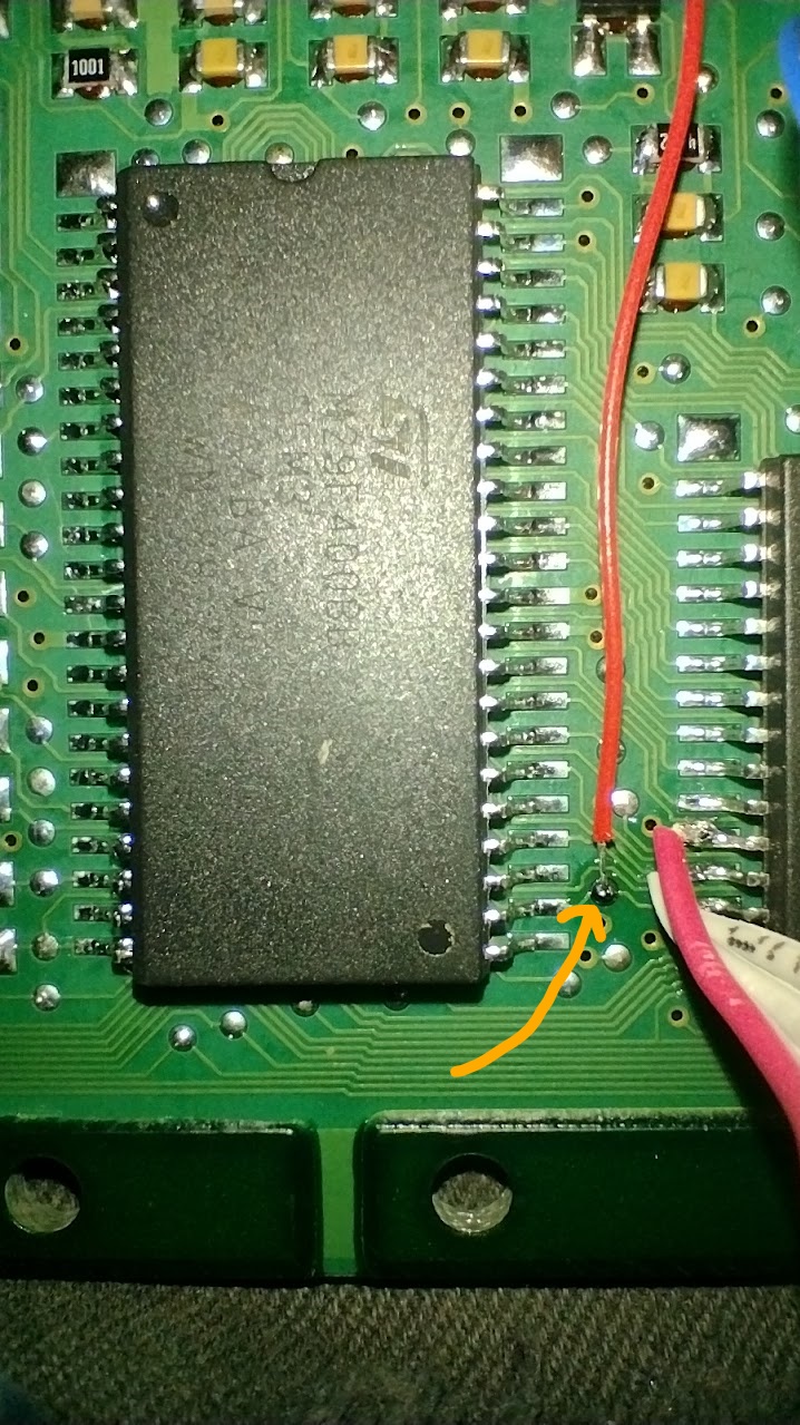

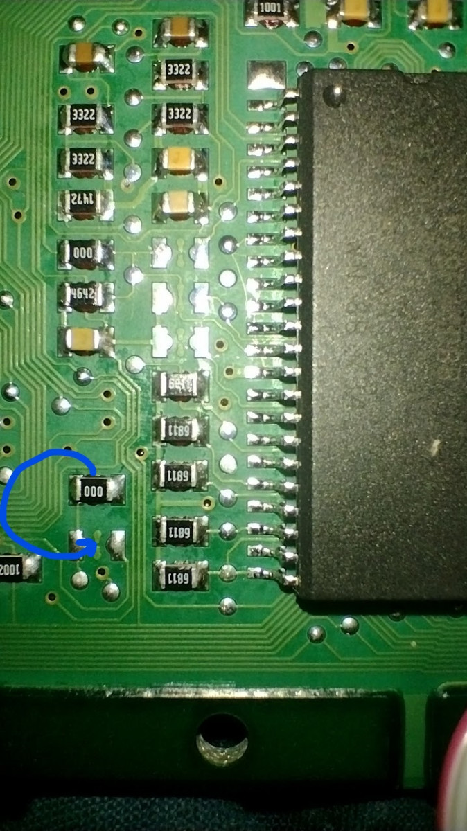

attached are two pics, the 0ohm jumper resistor sets the boot mode. As shown it'll boot from the internal MaskROM (can be used but not ideal). Moving the resistor down to the pads below it will tell the CPU to boot from the 512kbyte external Flash (Much more convenient)
The other pic is showing the bootstrap pin. When this is logic 0v at system power up or after a reset signal is asserted, the CPU will jump to its internal boostrap code. This pin is shared with the Flash data line so best not to short it to ground, rather a 1k resistor to gnd will do the trick.

A little more progress. I found some similar ECU schematics, most of the routing appears to be the same across the ME7 C167 ECU's which is nice.

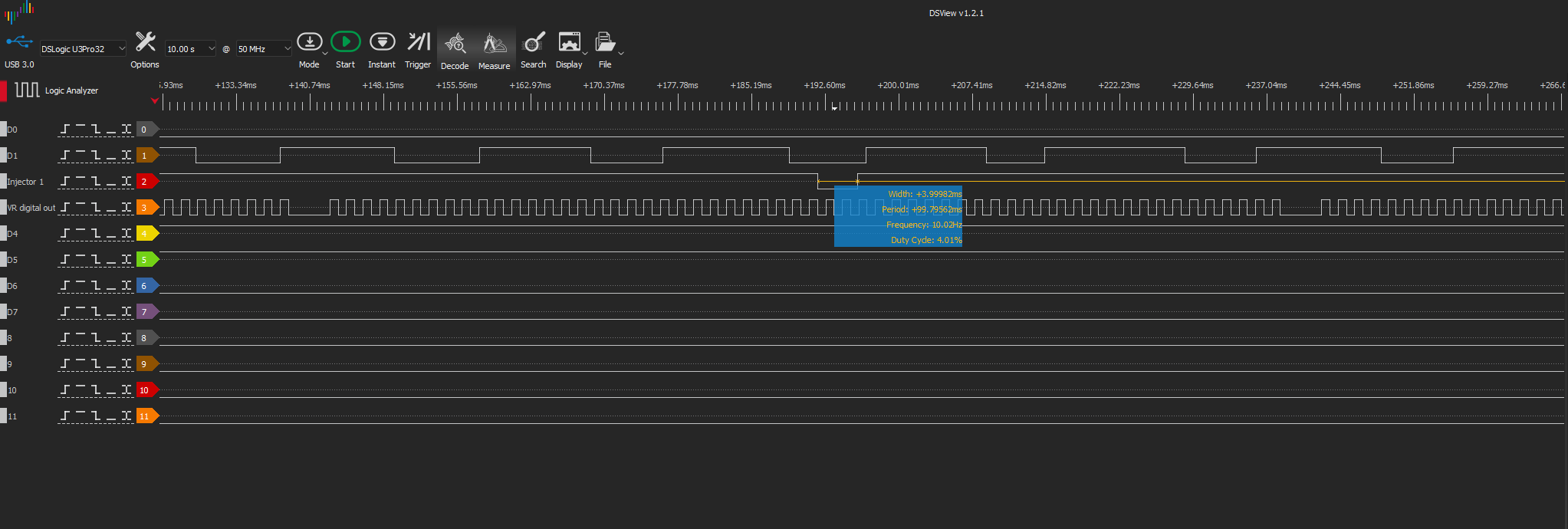

I've captured 5 seconds of data to the knock IC and decoded the first 500mS or so which should include the watchdog reset. Here's what I've found:
There are regular writes at address 0x38, 0x3E and 0x44 with bytes 0xE0, 0x0F, 0x09 every few mS which could be a request for ADC sampling or maybe the watchdog servicing, maybe both. I'll write some code to replicate this and try identify exactly what is what.

These are all the analog signals that are on the peugeot / Citroen wiring diagram. There are more ADC channels that are sampling pins on the ecu connector so we have more ADC's for wideband, oil pressure, coolant pressure etc. We've also got outputs for drive-by-wire, wastegate actuator solenoids, intake runner flaps, VVT( though no secondary VR input for a VVT pid loop, we do have an extra hall input signal intended for vehicle speed) We also have canbus hardware in the ECU we could use to read/control other actuators, dash clusters etc.

Ign and inj timing is tested too, attached is the coil firing for the requested 4mS dwell at 183deg btdc. I'll need to code up a function which converts dwell duration to angle so the end of the ign event lands exactly on 183deg. I'll probably use two separate timer channels, one to trigger the dwell and one to fire the coil incase the engine is increasing or decreasing RPM during the cycle.
I've decided on 0.5degree timing resolution. The limitation is at higher RPM (7000+), and the timers resolution. Right now at 10,000RPM we're off by 1/4 of a degree vs requested which is acceptable. If you're never running it up that high, you can change a variable which sets the resolution and run down to 0.1deg resolution. Given there is very little performance difference in a degree of timing, 0.5 is where I'll keep it.
