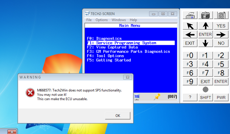

no workie.png (210.93 KiB) Viewed 12854 times
How do you get TIS 2000 work with tech2win? I just need to do some BCM and radios updates on my 2005 truck. The tech connect line won't change my RPOs so I can't add features to my truck. We need a BCM hammer.

You use tis2000 to program and use the tech2 as a pass thru device. You do NOT use tech2win..
Same problem though, bcm options are not changeable and are determined by vin. Radio's usually have some options back then as far as speaker setups and such.

DodgeZ wrote: Mon Aug 12, 2024 11:57 pm you can set the vxdiag nano as a passthrough?
I do not know that answer, I just know what tech2win is not used with sps programming.
If it's a J2534 device then it "should" work with sps programming.
Start tis2000 and try the pass thru option as a device is where I would start..

You can use Tech2Win just not for SPS, open TIS2000 select programming and select device "Generic Pass Thru"
