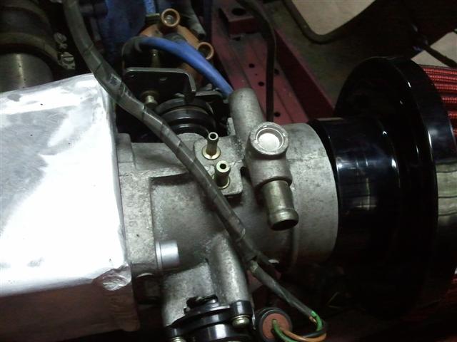

And can anyone tell me if the large port on the top of a v6 throttle body is the vac line for the brake booster? If not, my plenum needs another modification ;)

that large fitting in the picture is where the PCV normally connects to, for the brake booster just put a fitting into the plenum somewhere
i haven't really had any experience with longer map sensor hose but i wouldn't think it would be an issue.

Holden202 wrote:that large fitting in the picture is where the PCV normally connects to
That would make sense I suppose, considering it's on the wrong side of the throttle plate for a vac line :oops:
