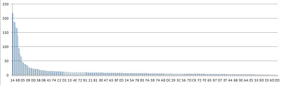

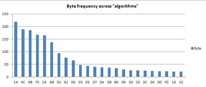

I plotted the byte frequency across all the algorithms (i.e. how often each byte appears), and it's a very logarithmic distribution - which may indicate what are operators and what's static data. It seemed like a fitting distraction for a friday afternoon
For example, there are over 200 ocurrances of 0x14 between the 256 algorithms. and the top 25 or so: If you could narrow down the CPU, there's a lot better chance of making sense of it all
