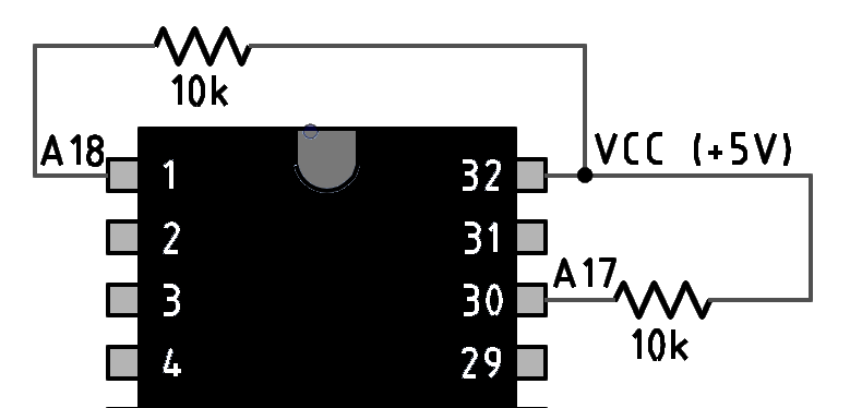

It sounds as though the unused address lines on the ostrich are floating and being interpreted as being a logic 1, therefore selecting a higher bank (not uncommon with TTL chips). a pull-down resistor (say 10k ohms) from pin 1 to GND and from pin 30 to GND should help.
If you don't want to mess around with the stacking I would do this and then just upload a 128k bin to the ostrich (making sure it is end justified).
