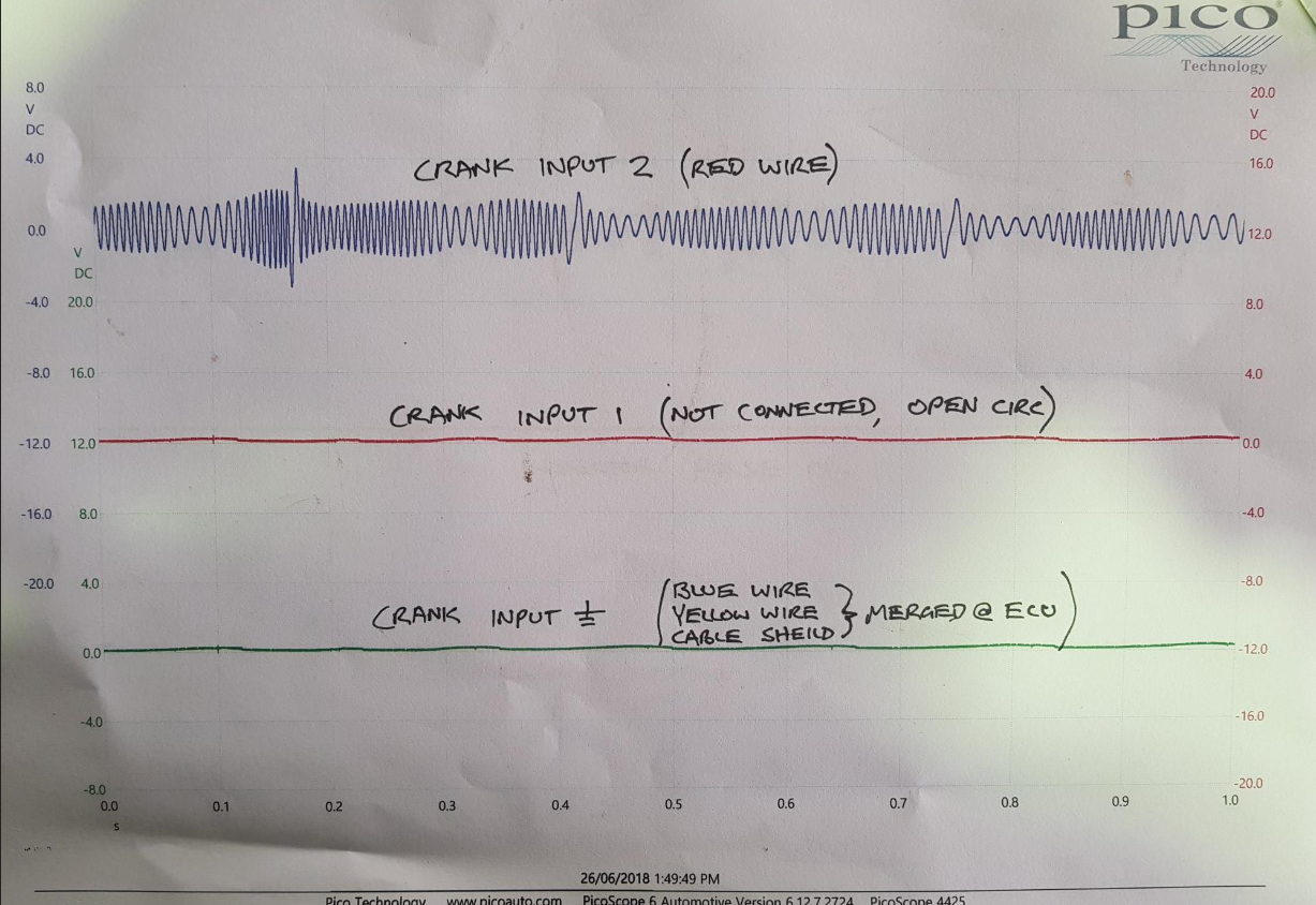

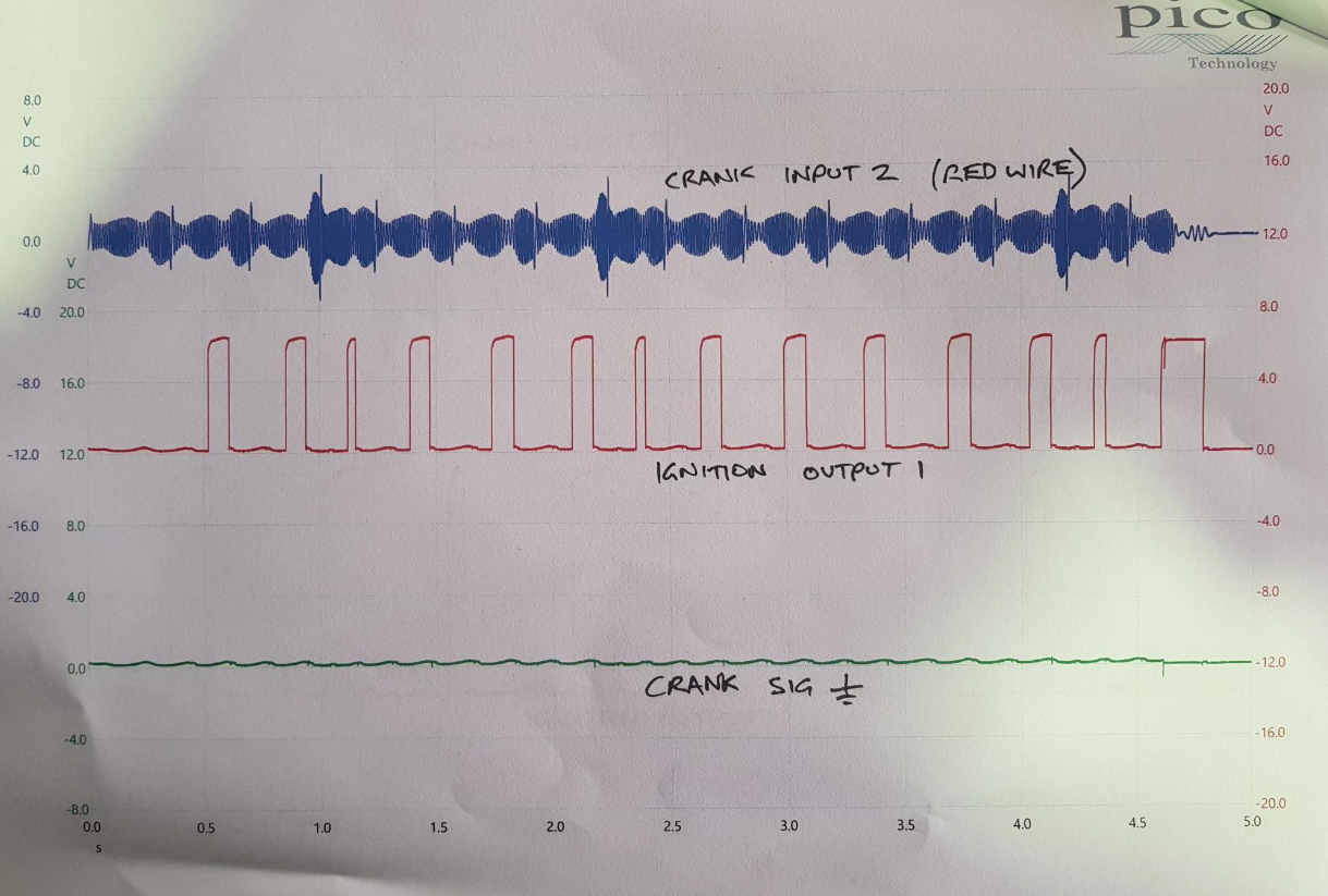

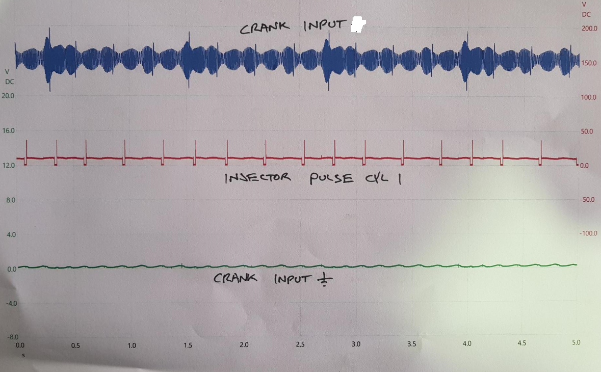

It seems to crank over and fire occasionally. I've put the scope on it today and found a few things:
-Its firing the the same cylinder every 2nd cycle (4 revolutions)
-Injector pulse is constant
-Ignition output is constant
-Ignition timing jumps from 5 deg cranking to something like 18 degrees every time it fires. Cannot work out in microtech software why its doing this

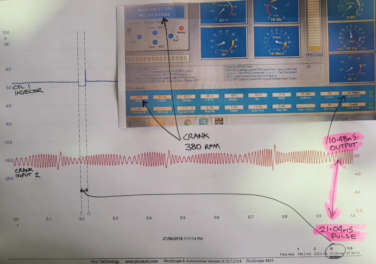

-Injector pulse is exactly DOUBLE what the software says it is
Clearly something is not setup right. When it does get running it idles warm with 3-4mS injector pulse (on the software display) with the wideband say 14:1. I'm not sure if this is actually double that in reality. Cranking cold the software is saying 10.5ms (it was almost 20mS before I started playing around with it), but the scope proves its actually outputting 21ms (exactly double). If it was outputting 40ms before hand, no wonder it flooded every time he tried to start it cold.

actually it might be a double pulse mode for large injectors - where the pulse is doubled and delivered half as often. Try looking for thresholds for this mode, might be set incorrectly.
pman92
Posts: 466
cars: HZ One Tonner
VE Ute
Location: Castlemaine, Vic
Re: Microtech LT10S help
Post by pman92 »
ejukated wrote:actually it might be a double pulse mode for large injectors - where the pulse is doubled and delivered half as often. Try looking for thresholds for this mode, might be set incorrectly.
Something like that would make sense. However it is delivering a pulse once every revolution (2 pulses between each intake valve opening). I'll send microtech a message with the form on their website which seems to be back online now
