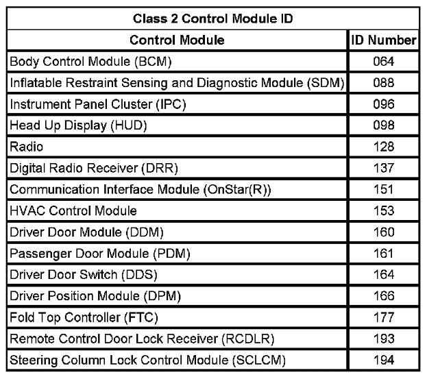

You convert module ID from hex to decimal
$10=16 [PCM]
$40=64 [BCM]
Than you need a list with DTCs from GM starting with U
U1[016] = loss of communication with PCM
U1[064] = loss of comm with BCM
Compare the dtc list with the unknown module ID and you will find it`s name.

Here is a quick chart of modules found in corvettes.
176=REMOTE CONTROL DOOR LOCK RECEIVER
56[$38]=ELECTRONIC SUSPENSION CONTROL , either don`t have it or module is dead.
