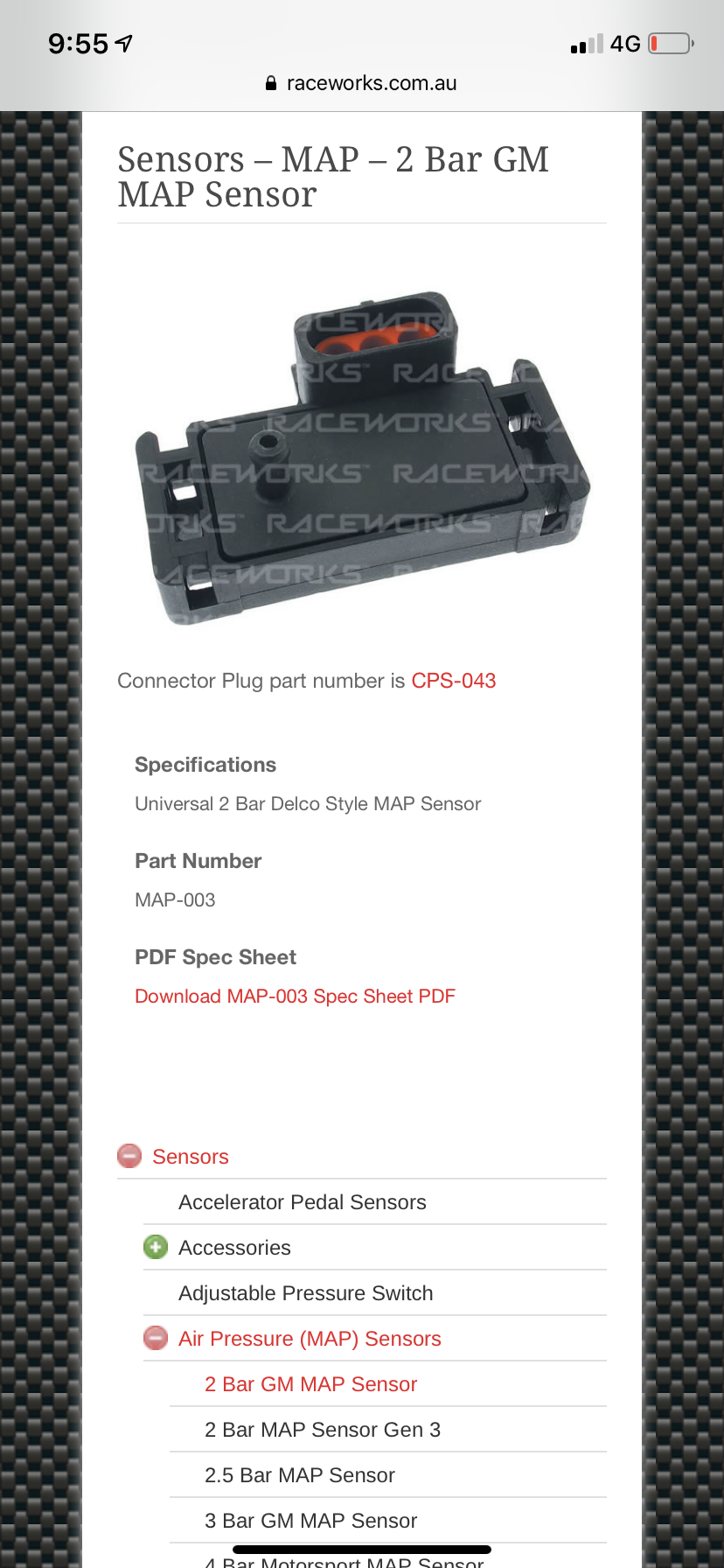

Was having a look through a racewoks catalogue the other day and noticed they have 2 and 3 bar map sensors.
Just wondering what if anyone here has any feedback/ experience with them ?

I know one person with 2 of these that got thrown in the bin and swapped for ls style they were both bad to the point of rough running and constantly changing engine operation

99.9999997% of these on the market are pure shit.
As Delco said, best to retrofit a genuine LS style one. which I would only buy from GM direct.

If you wanted this style, this would probably be a safe bet. https://www.haltech.com/product/ht-0101 ... ap-sensor/
I have one my sr20 gemini its its good for 18psi. It looks like they dont have 2 bar, but maybe you could use 3 anyway.
But yeah the ls1 sensor option is a good one, and seems to be simpler these days.

I had problems with one of these type 2 bar Map sensors (well it actually came off ebay ) running rough at idle & dying as you tried to get off the line quickly. We ended up wiring in a genuine LS1 2 bar map & I had no further problems.
