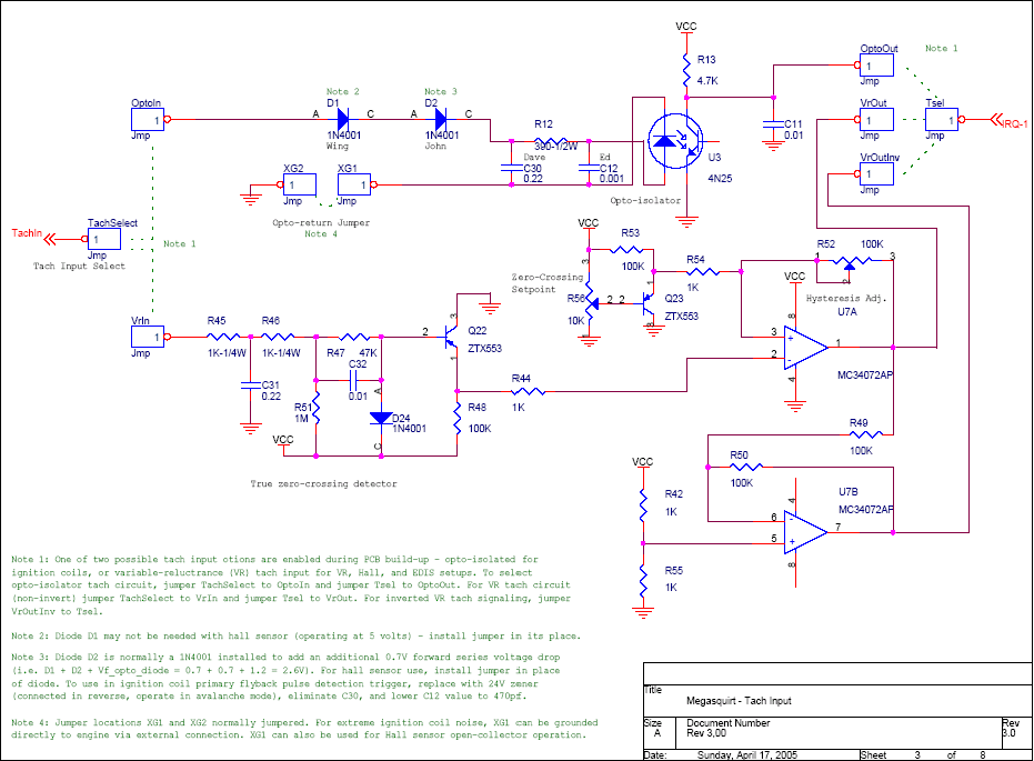

What you need is an LM1815. Will work perfectly for your application, there about $15AUD for the IC though. Its basically whats used in a Camira module to convert the reluctor to square wave.

well thanks to XR_pilot i have a couple of schematics for maybe making what i need to convert the VSS signal

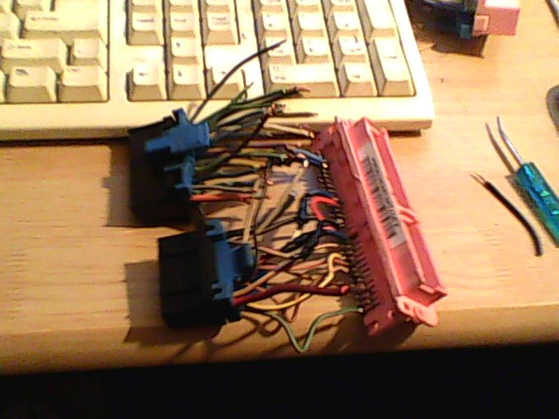

well heres my latest creation to do some VSS circuit testing in the vr.ive made a patch harness for 808 to VR auto wiring just finishing the second plug now.part of a VS ecu and some 808 plugs should work ok in the end
Re: VR AUTO TO 808 ECU
must have been fun getting that plug off the circuit board!!
- Posts: 5709
brute force and ingnorance mate .she came off pretty well actually considering i dont have a solder sucker
- Posts: 5709
well patch cable worked a treat all fired up and ran ok.think the vr has a dud O2 sensor fixed a manifold leak made it run lots better but the O2 volts kept dropping out so i think its toast.left my wiring swap diagram book at home so couldnt fit the camira module yet
