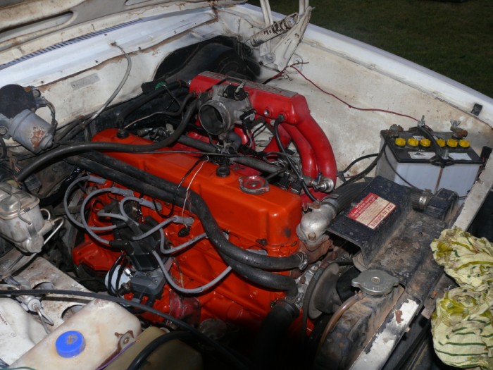

A bit of an update. I started fitting the injection gear to the UC this week, here's a few pics.
I had to add some O2 sensor bungs & move the secondary pipes on the extractors, as they were to close the the trans. So while they were off, I had my mate media blast them then painted them with heat proof paint to make them look a bit better. Just need to hook up the fuel pump & fit some relays & connect a few wires, which will happen today then I can fire it up & start tuning.
