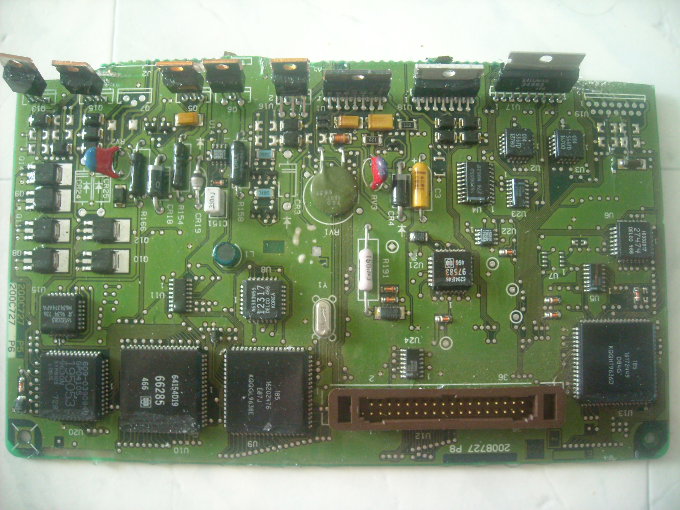

what about taking an 808 ecu and soldeing the ALDL chip off a dead VS ecotec board like this one.
sorry about the file size, wanted to keep the detail.. anyone know which chip is the ALDL one and if it will work soldering it onto an 808?
- Posts: 10111
Re: '808 high speed comms mod
I think its U8. Yes that would work but there are also a couple of other surface mount components missing that you'd need to populate. VL400 would have more details. I think he was designing a ALDL interface designed to drop in there on an 808. Im not sure on the progress, so many projects all on the go!
Yeah I made a small board that connect to the 808, the problem is its really fiddly to install. Will revise the design and make it wire in for a simpler install. The idea was to just solder some small pins to the round pads (not the actual U8 connector pads as they are too small) and drop the ALDL conversion board on the top. You need to jumper one link on the underside of the ECM and the one wire data then appeared on the normal data pin like a '082. It worked ok on the bench
