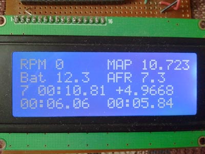

Still making progress...
Top 2 lines are the ADX objects with IDs 1-4.
3rd line is lap count (7 laps here), last lap (10.81 secs), and difference between last and best laps (last was 4.9s slower than my best).
Bottom line is current lap, and best lap.
The lap trigger is any one of the spare digital input pins, with the ADX ID set to "Lap".
I'm using C15, grounding to trigger a lap completion event.
Not a very neat screen layout, but I'll worry about that later
