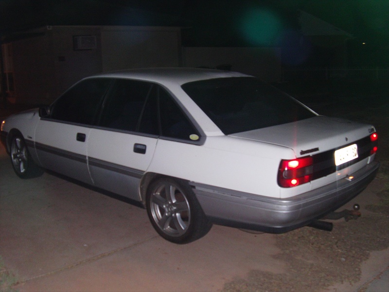

chucked on the ss wheels just to suss em out, seem to suit the white over silver. about to solder in the usb comms board and install nvram to the 808 now the 14 hour shifts are over for a week

Re: the vn calais
looks 100% better with a decent set of wheels on it!

looks much better, what's the vac kit cost?
