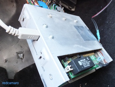

[Edit] BTW: Here's a pic of my '87 Camaro 1227808 ECU, with NVRAM, USB, OSE $12P, MAP Sensor
87 Camaro 1227808 ECU NVRAM USB OSE $12P MAP Sensor
I tried running Super_AUJP ($8D code) and the car does start, but it won't run.
It stalls as soon as the throttle is opened, even slightly.
With no throttle at all it starts and then stops after a couple of seconds. That might be an A/F mixture thing, or do you reckon something else?

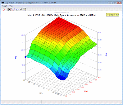

delcowizzid wrote:spark is easy goto 100 kpa colomn and add your typical chev WOT advance curve 800 rpm say 16-20 degrees ramp it up to 34-38 degrees all in by 3600-4000rpm in the 100kpa colomn and you will pretty much have a full msd dizzy mechanical advance curve and be close enough to make allright grunt off the bat at full throttle.goto the map colomn your engine cruises in say 40-50 kpa if theres a bit of cam and add 16 degrees timing to the 100kpa value at each rpm and enter that in the cruise map colomn this will give you the equivilent of the msd vacuam can at cruise on top of full throttle spark advance.taper the whole table from 50-100kp so it nicely slopes and that should be a good enough base spark table to fine tune from.
as for the ve table as long as you dont guess the injector constant its as easy as sit in the driveway for half an hour with your foot on the gas with bubble tracing on and and getting the bubble in as many cells as you can 1 by 1 and increasing or decreasing ve untill the engine sings youll hear it free up as you add fuel and youll need to keep lifting your foot further off the throttle to keep in the cell you are tuning.do this with closed loop disabled in the tune.full throttle set 100kpa colomn to all above 90% VE and lean out and richen where needed
I'm going to try this now. Now that I have no more Knock Sensor problem. Yippee :lol:
[Edit - when I've done it I'll post a short log] I get what you mean because I started to do it, but I don't think I did it right - messed it up.
Should the SA curve look something like this?
Spark Advance
Spark Advance
redcamaro Spark Curve.GIF (30.99 KiB) Viewed 4421 times
Posts: 5632
Re: Transfering Calibration from ABUT ['165] to OSE $12P Tab
should be good enough to get you started and driving .then just get yourself a driver to cruise around in each cell and adjust spark advance for max vacuam 30-40kpa and minimum TPS which will be max torque timing.you can use the breaks to raise load into the higher map cells once you see a pattern emerging you should be able to wing adjoining cells
