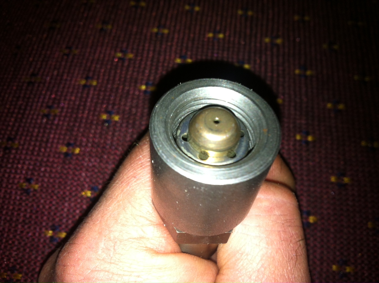

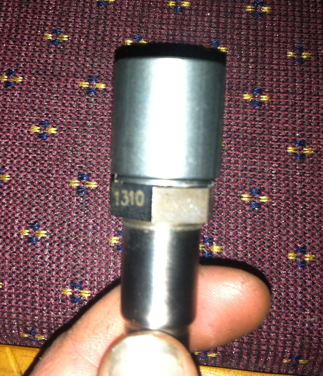

Just about to install the Mtx from innovate but curious on the bung supplied with the kit. If I weld the bung on with its current length the sensor would only be in the exhaust about 3-5mm. Will that be enough? Normal O2 sensors are buried in a lot further. Not sure if I should cut the bung down a little to get more of the sensor tip in the exhaust pipe.

Sorry, just got home from work and checked it again. It is flush with the end of the bung. If I hole saw a hole slightly smaller than the bung and weld to the outside of the pipe it would not even be in the path of the exhaust gases.

I would have thought some of the sensor has to be inside the exhaust pipe.

Re: Want to add a wide band O2 sensor, Kit suggestion?
Post by charlay86 »
Whoa that is a long one! Ones like that are designed for when you have really hot EGTs to keep the sensor from overheating.
If you are mounting it in the usual position you can probably cut it in half.
I cut off a fair bit (prob half) before welding to the exhaust pipe so the tip of the sensor is in the stream.
