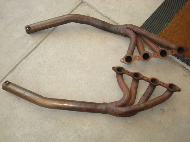

Lol,i think i hold onto parts too long.
I should be sponsored by ebay as most of the parts on this car are ebayed.
The extractors were fairly cheap because of no flanges.
The intermediate was $25 because it was sitting in a blokes sisters backyard and she was sick of tripping over it.
Its a 3'" into a 2"3/4 and a standard muffler which i cut up and added straight through pipes.

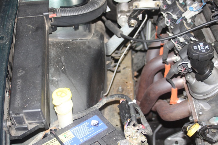

I picked up a complete VE SS exhaust just for the bolt on flanges and welded them up to mine.Unbolting the whole exhaust is now a breeze.
I drilled out the spotwelds and removed the bracket that holds the cruise module/ABS under the bonnet.
This helped when removing/refitting the driverside extractor when i had to tack things in place for the flanges etc.
Just the oil filler cap needs to come off to get the RH out. :thumbup:
vt exh.jpg (184.63 KiB) Viewed 9300 times
I also added an extra bung if want to run the Motec PLM from the munro. Soooo thats the exhaust side completed.

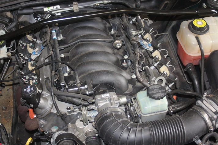

I was in 2 minds about going with the tuff mounts or the stock engine mounts.
Cost wise and trying to keep the $ down and it is a "play" car,i went with stock mounts.
I also fitted a later model p/s rack which i picked up for a good price....wasnt sure if V6 were the same (clearance around the sump) so i didnt muck around.
Engine,trans,exhaust and all mounts all fitted up.
A/C and all the stuff not required was removed.
vt eng1.jpg (180.41 KiB) Viewed 9298 times
vt eng2.jpg (198.3 KiB) Viewed 9298 times
I had to chase up coolant reservoir,all new rad hoses etc.
Another little problem i had was the radiator fans.As i thought i had a VY loom,i ended up getting a VY radiator and fan set up. (more on that later)

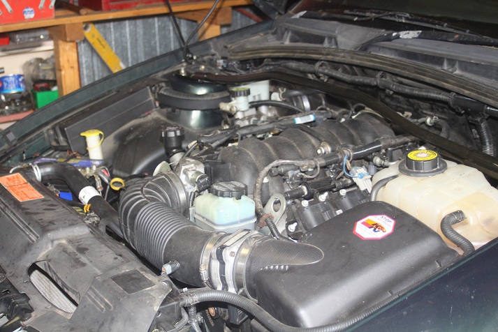

OK......The electricals (not my strongest point,but i somehow manage).
Here it goes :? I have a VY auto body loom - VY auto LS1 ECM - VY BCM/key - VX auto LS1 engine loom and i wanted it to fit in a VT S1 V6 auto :lol:
Simple,modify the looms,get the VATS off,put it all together and make it run as an LS1 manual :lol: :lol:
Well first off,i wanted to make sure ALLthe sensors and instruments/guages worked if i wanted to check for faults if i had to borrow a Tech2.
As i layed the looms out i noticed the VY body loom plugs were different to the VX engine loom.The VT-VX has the 3-4 connector blocks that sit on the RH rear of the strut tower.
The VY body loom doesnt :thumbdown: then i wasnt 100% sure if the pinouts of the VY ECM was correct for the VX engine loom (2 or 3 wiring diagrams show differences)
I didn't want fry or damage my ECM or wiring from being unsure....and i did check a few times,so for the sake of it all i chased up a VTS2 LS1 manual engine loom and ECM.

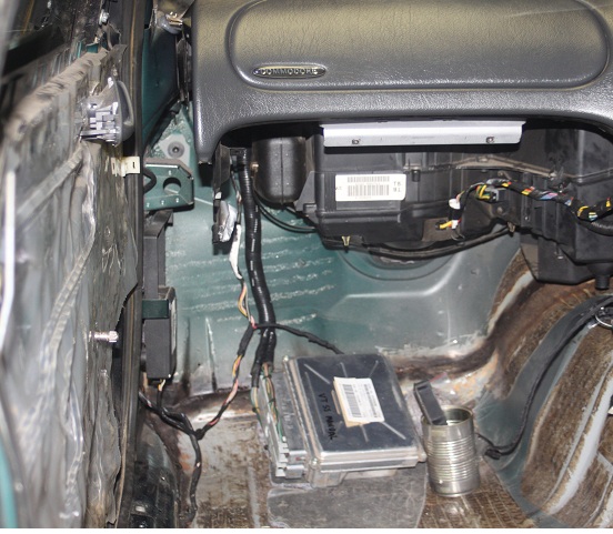

I wanted to move the ECM from its original position of the LH strut tower to inside the cabin.
Just had to unpick the tape and lengthen 1 wire (reservoir coolant level sensor) and put it all through the 1 grommet in the firewall...job done and neater.
ECM will be finally mounted once the cage goes in.

Yeah still coming along nicely, & never liked the idea of the PCM on chassis rail right beside headers so nice work there too!

Nothing better than heat,vibration and whatever else that can be thrown at the PCM under the bonnet. :thumbdown:

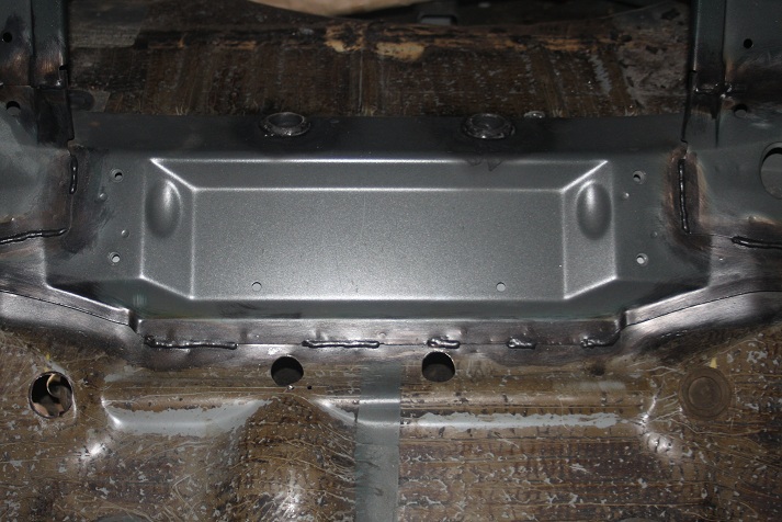

After playing around with the rear cradle,the 4 top diff bolts are a pain to undo on the ground.
A big breaker bar and pipe is usually required,plus the rear stab bar sits over the 2 front bolts.
I decided to make it easier for future removal if needed.
The diff sits directly under the middle seat/ski porthole of the floor.
The 2 outer holes are the stab bar bolts and the 2 inner are the front diff bolts.
Undoing 1 stab bar bolt and moving it with my fingers is enough to uncover the 2 diff bolt heads.
The rear bolt holes were through 2 panels and i put steel tubes in them,i then cover the holes with rubber grommets.

LMAO, nice work yeah I always have to use a short spanner & pry bar to crack them up in the car & fits under sway bar but drilling holes would make it easier & nice work on the support tubes for section cut out!

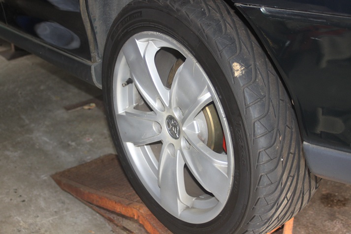

I was going to use these 16" wheels that came with the car
I really wanted to go 17 or 18's if something came up.
Then a workmate mentioned that he was buying new wheels for his ute and i asked what he was doing with his old 17" VY ss wheels.
He said he was doing nothing with them as they are scratched,faded etc.
I offered to buy them if he wanted to sell them,so i got them for $100.00 :thumbup: All the tyres are pretty good too.
ss wheels.jpg (139.43 KiB) Viewed 9154 times

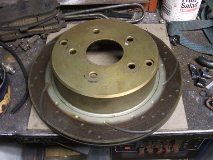

These HSV rear calipers (EBC red or green pads)and just about new RDA gold 315mm rotors came up on ebay starting at $200.00,i offered him $350.00 but he wanted more.
No one else bid on them and i got them for $200.00 :D
rear caliper.jpg (137.64 KiB) Viewed 9154 times
rear disc.jpg (130.05 KiB) Viewed 9154 times
Thats the rear taken care of !

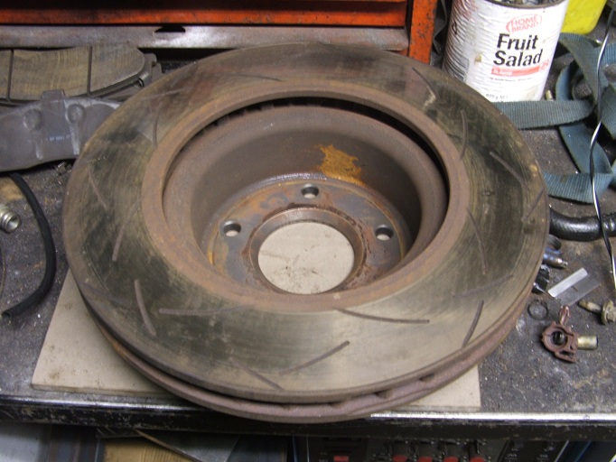

Next up...Front brakes.
I'd been keeping an eye on the 330mm brakes off the HSVs for a while and kept on getting outbid (sometimes silly prices)
These were a buy now from Q/land but it was pick up only (i'm in Vic) but i thought i'd try my luck emailing him if he would post....$290.00 delivered :punk:
(maybe braided lines later but a mate races historics and they still run the standard hoses and says they are fine) except my hoses exit the the pipes on the body
at a different angle being non abs.
front caliper.jpg (98.6 KiB) Viewed 9152 times
front disc.jpg (125.25 KiB) Viewed 9152 times
Brakes just about sorted :punk:
