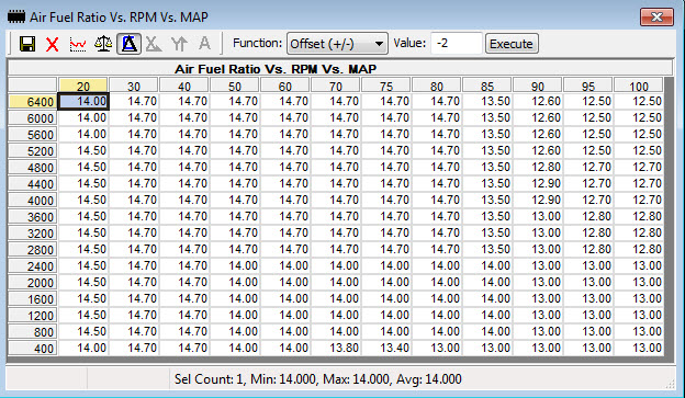

i wouldn't touch the closed loop enable temp, i would change he low rpm 20-100kpa AFR table, i did this with my mates car, commanded 14.0 up till 2400rpm cause when cruising below that rpm with the 286 cam it was surging etc.
also that cam probably wont be happy idling much leaner then 13's!
i've attached the afr tables i used in it.

if you put 14 afr's in the 20-100kpa AFR table it wont go into closed loop at idle, also don't confuse closed loop idle with closed loop fueling! closed loop idle is just the ecm controlling idle rpm, not fueling.
as far as tuning wideband to match commanded AFR this is done via the VE table and should be done when the engine is at operating temp, usually once its right the rest is right.
open loop uses a calculation of commanded AFR, ve and other offsets to work out the amount of fuel to put in, so if ve table is wrong it will always change.
