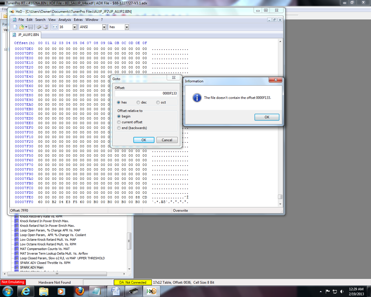

so on the address bar on the left im looking for 0000F133? or 0000133? or 000033? still cant find it and its driving me nuts LOL

charlay86 wrote:Just ignore the 'L', you are looking for 0000F133
yeah its not me then, address only goes up to 00007FF0. dont know where else it could be lol

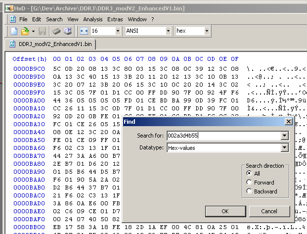

hmm ok, well you can try searching the bin file for the table.
tunerpro's hex editor can't search so you'll need to use something else, eg winhex, HxD.
Re: Re-scaling MAT counts table $8D SAUJP
The bin must be only 32k, so its 0-7FFF in size. The ECU/processor maps it to 8000-FFFF, so in ECU speak F133 is 7133 in your bin (7133 + 8000 = F133).
When I have looked at rescaling I found it easier to play with pull up resistors and leave the code alone, a temp sensor is highly non-linear so pullup choice is pretty critical for the range you expect to operate in.

ugh...somethings not right, its not there either. i must be doing something wrong LOL
