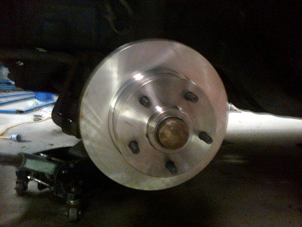

New disc rotos and pads all round ready for the new season.
