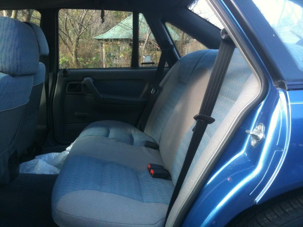

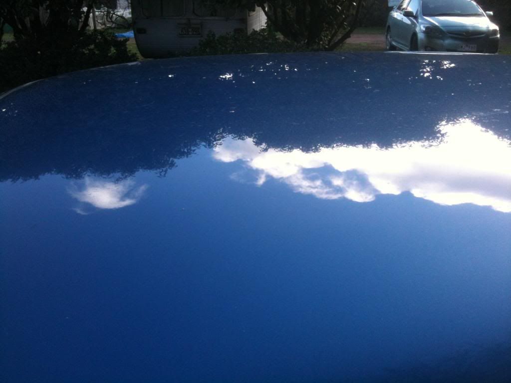

this is the only pic as when I bought it all the other good pics weren't available anymore due tot he car sold, to me of course. its mint inside and out.
EDIT: roll master make single row performance sets so that would probably suit better.
ok car is mine now.
Re: VR auto to manual conversion.
looks pretty tidy!
- Posts: 8600
that pic is an understatement, should see the engine bay and interior, straight off the show room

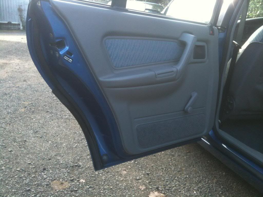

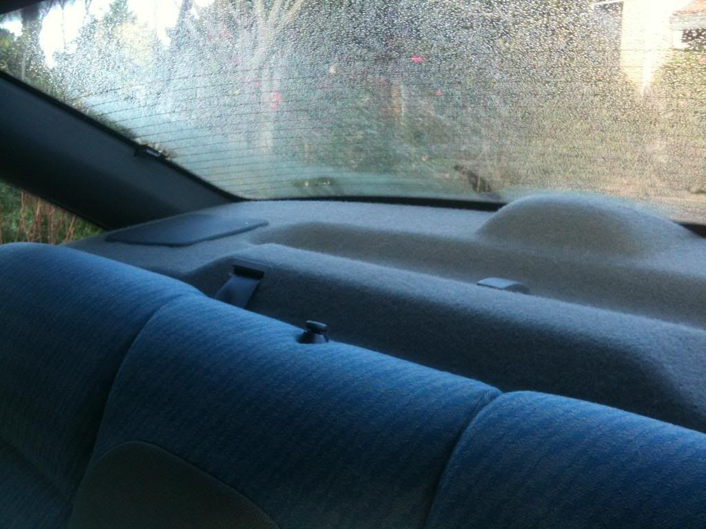

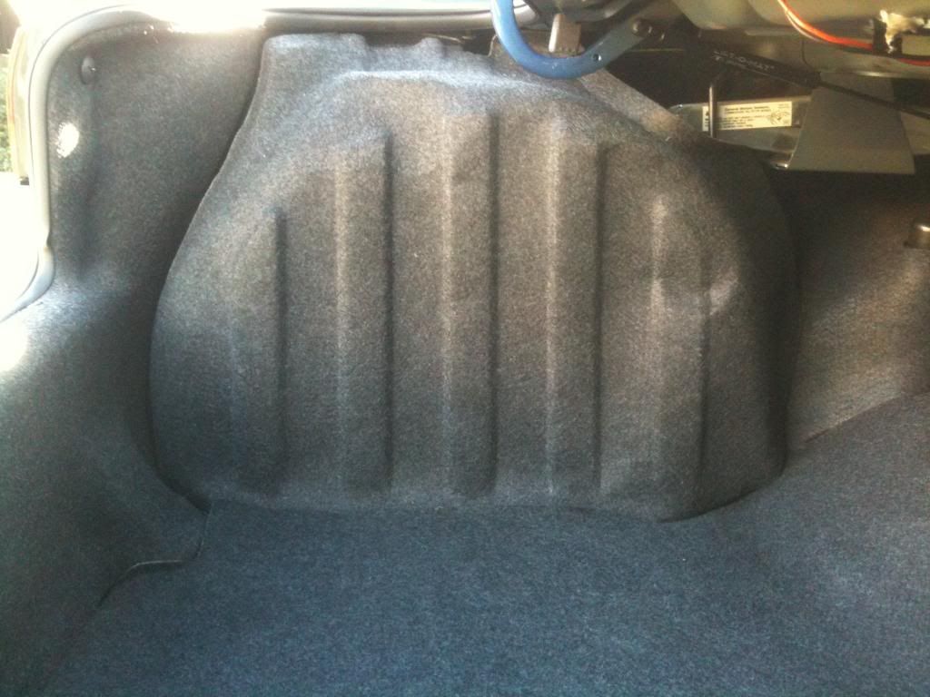

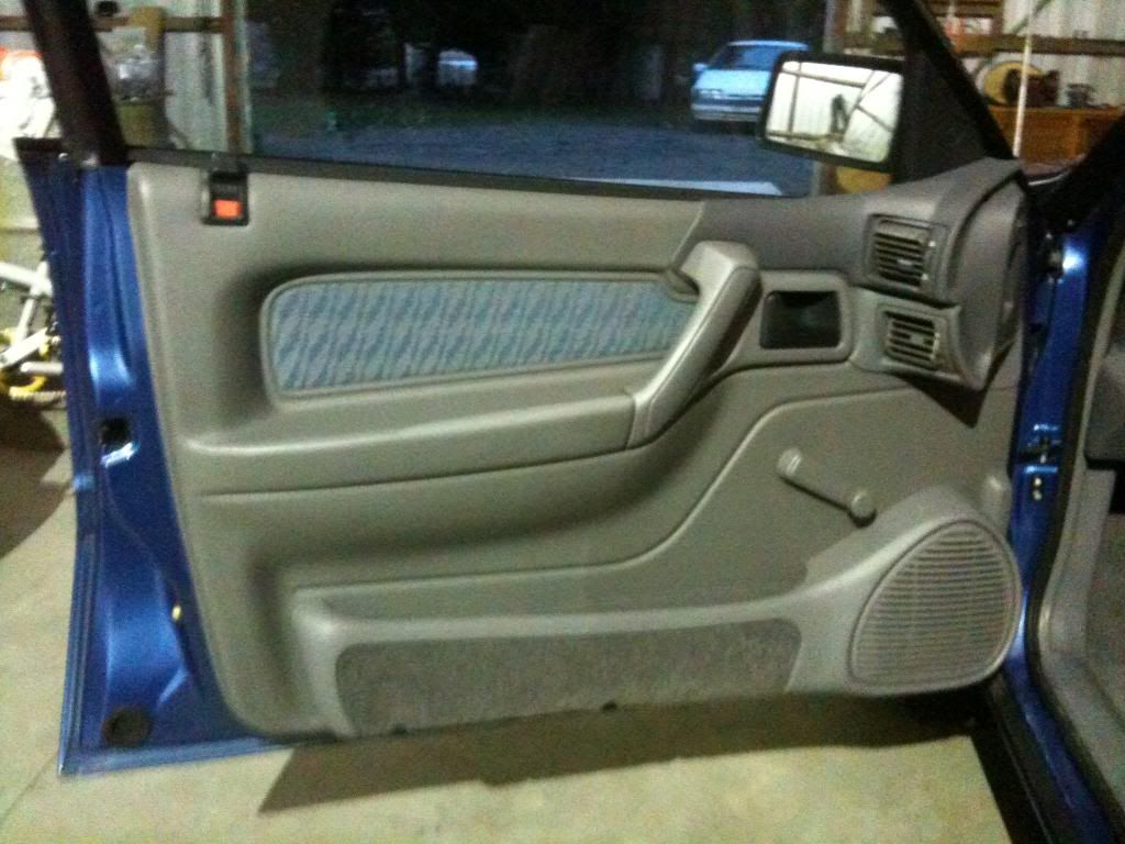

anyway here are some pics, man this car is awesomely mint. I am going to have to ask my boss to get me a company car, this is way too good to trash driving in Melbourne.
