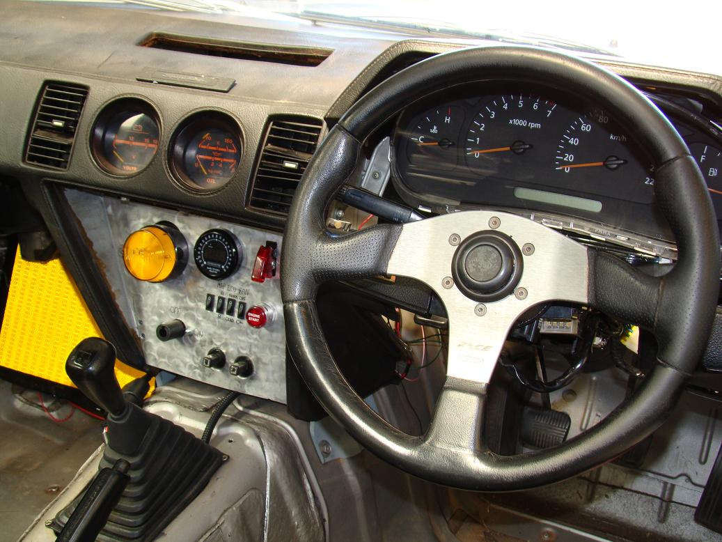

Another recent mod was needed since hitting the streets. Being able to estimate your speed is a good thing, but in the days of camera's everywhere and minimal tolerances I felt some accurate representation was best. Also the sound of a 3ltr blown V6 with a massive BOV and 3" exhaust also distracts you from trying to constantly guess if you are at a semi-legal velocity. With a faulty speedo, tacho and fuel gauge in the original Nissan dash cluster, the only logical $45 solution was to install and calibrate a VT commodore dash cluster!!
To make it super easy the VSS from a N13 pulsar sends the perfect signal for the VT speedo and screws straight into the Nissan BW T5 turbo 5spd manual transmission. Taken from a V6 commodore the tacho works perfectly with the Nissan V6. The temp sensors strangely talks serial so we are going to have work that one out. And the fuel sensor will need some thought put into it. Currently a full tank shows as empty, half full shows as full, and anything less than that is best guess.

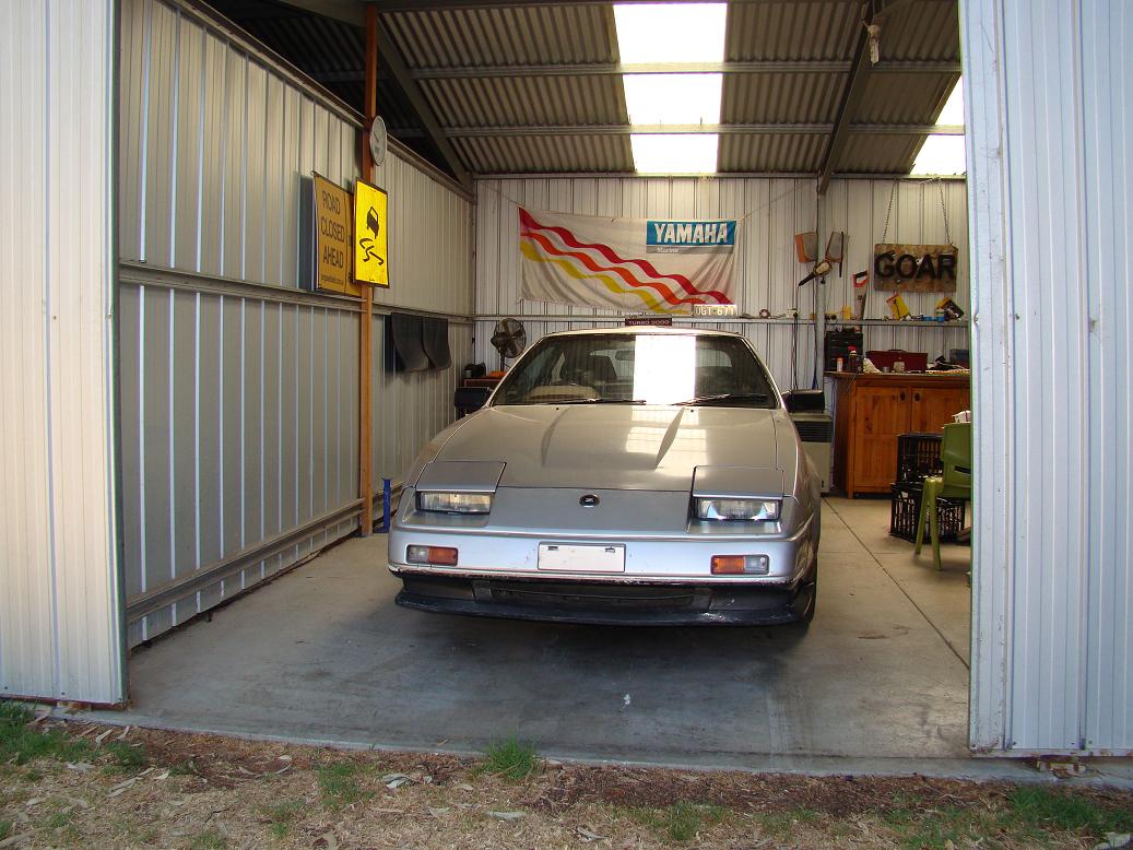

Re: Delco Nismo, 1984 300ZX VG30ET Turbo
Ha ha, the shed clean up was step one of a three day car bender that started Friday. A Holden Astra, Mitsi Pajero and then the 300ZX were all worked on in that space over the last three days. But that is where the Zed always sleeps come night time...

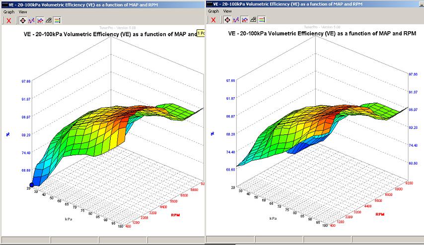

Now another update on an issue I think I nailed today. Up until now I've had an issue until the engine has reached a good working temp (~70 deg C) where when you step on the accel the engine goes rich and almost stalls. It then picks up RPM and the AFR levels out, but you needed to ease in the throttle for the first few minutes of running otherwise it would flood and stall. It was pretty annoying but as we had bigger fish to fry I just accepted it for a while. Even once it was warmed up it would give a little cough and lag a bit when you stepped on the go from idle, occasionally stalling. It also left big black nasty marks on the grass or concrete where it was started and rev'd to warm up.
But today I went about resolving the problem, and here's what I did.
Firstly the VE table looked a little odd to me, way down low. You can see (left image below) the region 20-60 kPa from 0-2K RPM seemed to drop right away. To me this seemed a little strange, and I know we built the table with generally rich AFR results which probably screwed our calcs so I smoothed this out in respect to the rest of the table. Results below on the right.

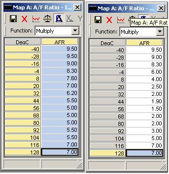

Also I found the "MAP A: A/F Ration - Initial Run A/F Ratio Offset vs Coolant Temp' table which seemed to the reason I was getting target AFR of ~10:1 on startup. In the 30 deg C coolant region it was offsetting my target AFR down to 8.5:1, and leaving black soot marks on the floor of the shed. I changed the settings from original on the left below, to the new on the right below: A test run after these changes showed good results. It was running less rich and responded better to a tap on the go pedal. But it was still not right, giving a cough and for half a second sounding like it would stall before roaring to life. The AFR was still dropping to ~10:1 as this happened so I looked a little further and found the acceleration enrichment table "AE - AE temperature factor vs coolant temp'. Not really knowing what I was looking at, but knowing at a high temp that things were much better I adjusted the lower temp values accordingly. Not knowing where to go I threw roughly half values in at the critical start temperature (South Aussie summer) and smoothed things out either way. The change was immediate and awesome. No more black smoke and soot marks, no more coughs and half stalls, it just goes straight to angry Nissan V6 noise mode!!!
Before and after values below: Disclaimer - Now this was all done with the trial and error method and with no consultation with professionals, technical documentation, tea leaves or google. I did ask the dog what he thought about it but his input was negligible. The results seem good sitting in my shed, but until I borrow a trade plate or actually register the car the real world changes are unknown. I am just posting it here to gauge opinion and perhaps a warning in case I have changed something that I shouldn't have...
