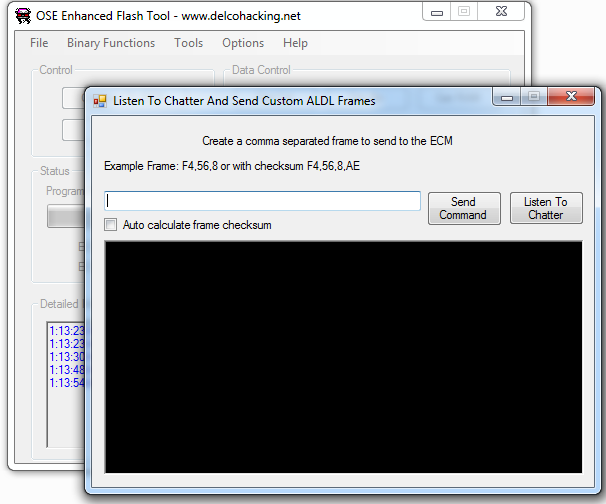

Quick check with portmon and the first command sent to the ECU is 'F4 56 01 B5'. I dont have a an ECU connected so no idea what the response is but you can easily check using either portmon (http://technet.microsoft.com/en-us/sysi ... 96644.aspx) or grab the flashtool and send a command https://pcmhacking.net/forums/viewtopic.php?f=3&t=82. In the preferences select 'OSE 12P '808' as the vehicle, 'USB ALDL' as the interface and the ECM com port. Then under the tools menu go to 'listen to chatter and send custom commands to the ECM'. Paste in 'F4,56,01,B5' and click send command.
The response should be all the data from the ECU, just need to work out each byte.
If you want to get an XDF started you need the bin, and until you know how to read it over ALDL (mode 2 that the elanscan software is using is the GM command that normally dumps data) you need a programmer.

Re: 1990 Geo Storm GSi Turbo
As as been said before, there is no support for your ECU with any tool on here. You will need to figure things out, to do this you will need to send commands and see what the response you get, or read the bin using an EPROM programmer and start looking through it. Having the Datamaster program to log it you have a much easier task of getting logging working in TunerPro but it will still take some trial and error.
If you want to figure more, use the flashtool to send some commands...
Send 'F4,56,1,B5' and post up the response.
Send 'F4,58,2,0,0,B2' and post up the response.

Just post it in the thread here on the forums. Have you sent the commands with the flash tool? Its under commands...
