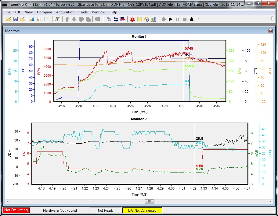

Re: VE Table Help
heres a target AFR for you compared to a wideband. (bottom monitor, red = target afr, green = wideband)
the trick with it is making sure the minimum and maximums in TP5 adx are all the same so they scale exactly the same on the monitor. as you can see TAF and AWB on the axis have the same numbers in the same spots. and this shows perfectly for me over the 1/4 mile pass that my fueling is pretty closely following the target but could do with some tweaking of the VE tables to get it spot on the whole way.
you also use the target and wideband to work out the percentage offset for VE's then multiply it by current VE to get a histogram of calculated VE which VL400 has added to most adx's I believe.
