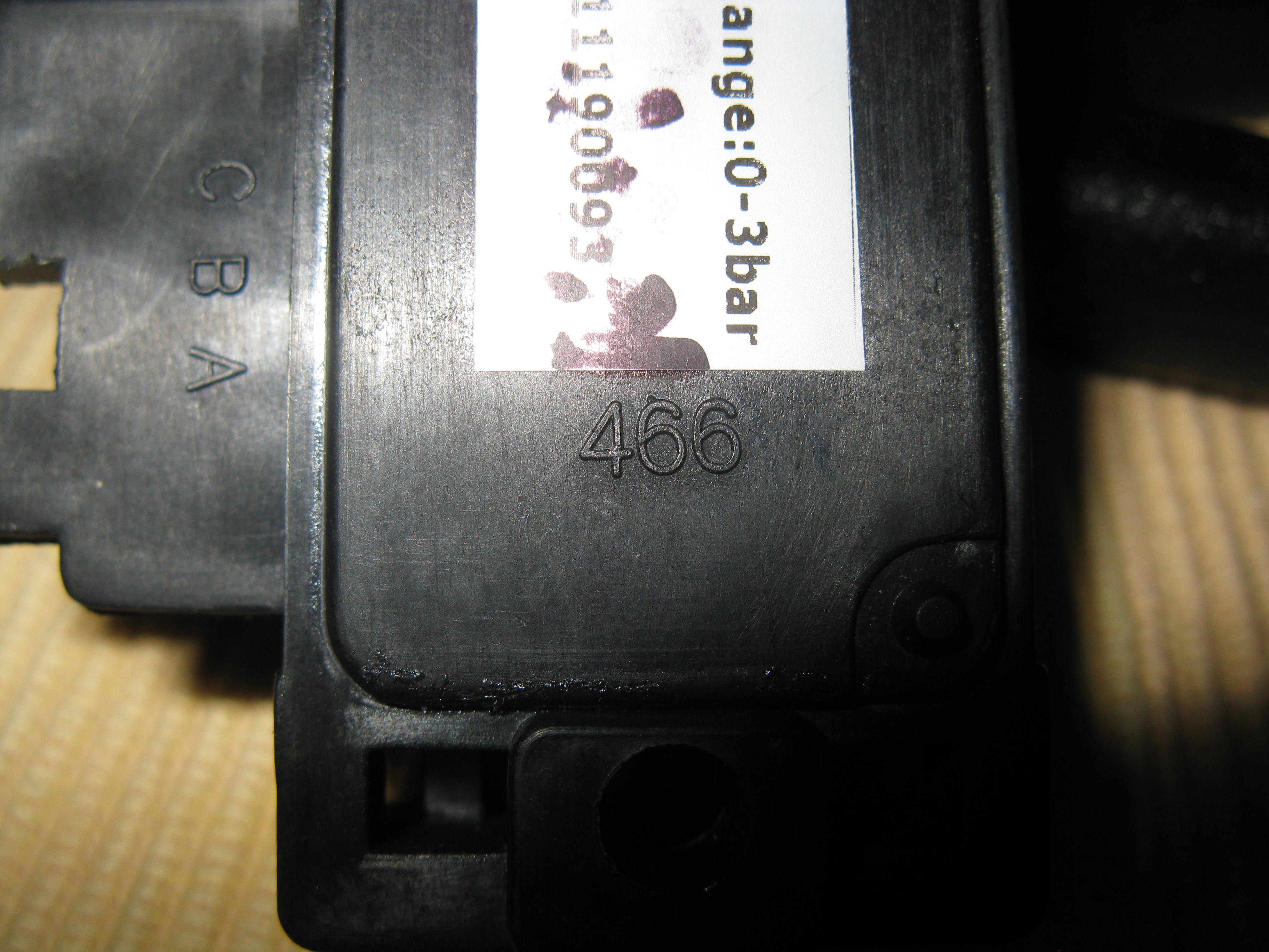

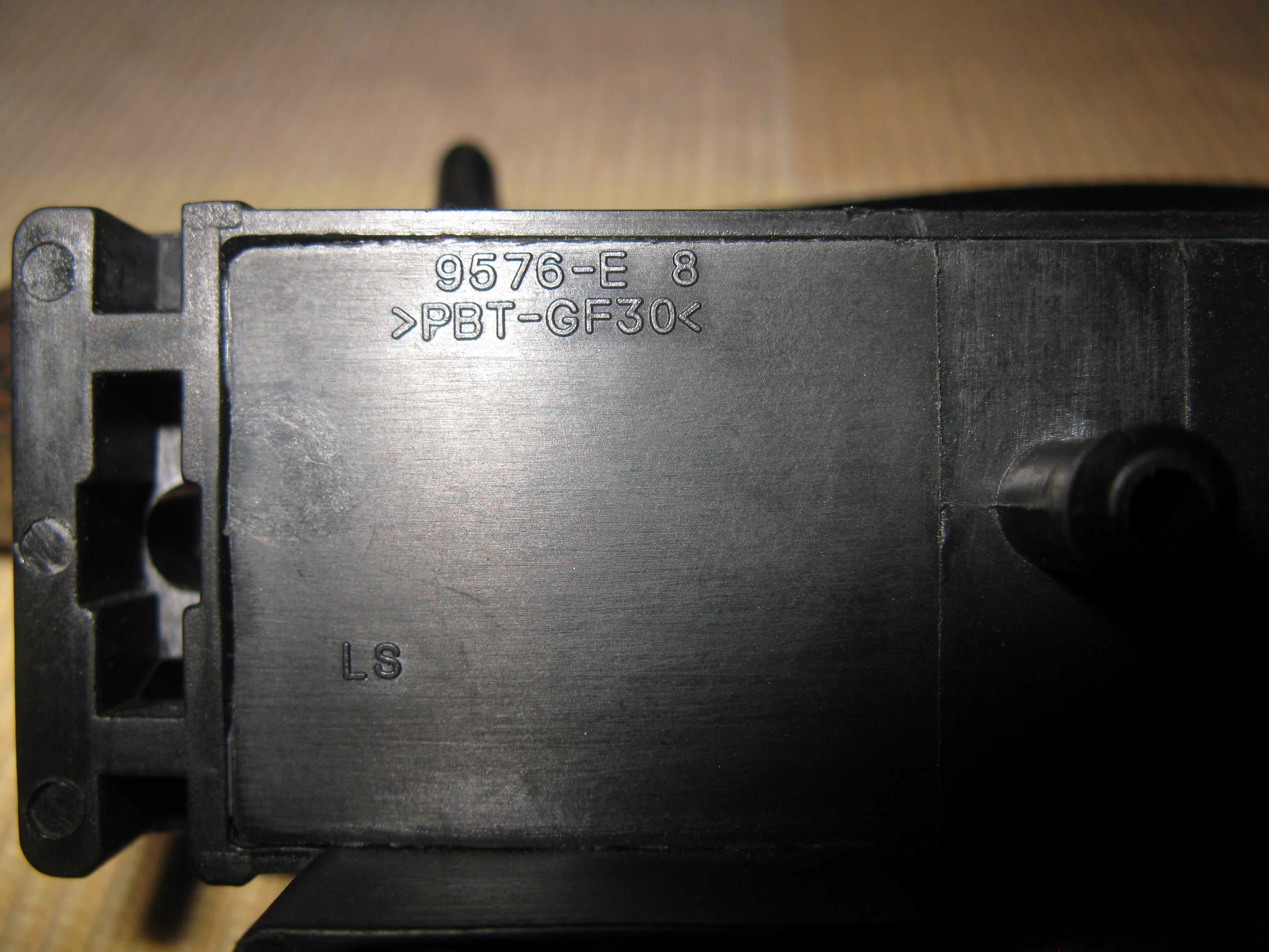

No I went to my old friend at AFI Southside who I have known for over 30 years and bought 1 off him. The part number is MAP1003. I know they only sell the best quality or OE parts.
The other sensors were part numbers
6150911190093 and 10030600125
However upon close look they also had other numbers exactly the same so my guess they were sold via different sellers but from the same factory in China my guess. I have attached 2 pictures of the markings that may help others.
If you want me to put the pictures somewhere else let me know.
