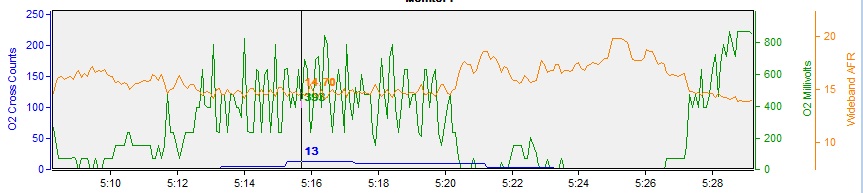

Here's a log from a Spartan's simulated NB:

looks pretty good! so i assume you have the spartan in your car festy ?

200-800mv swings sounds about right to me. I don't know much about the cross counts though.
