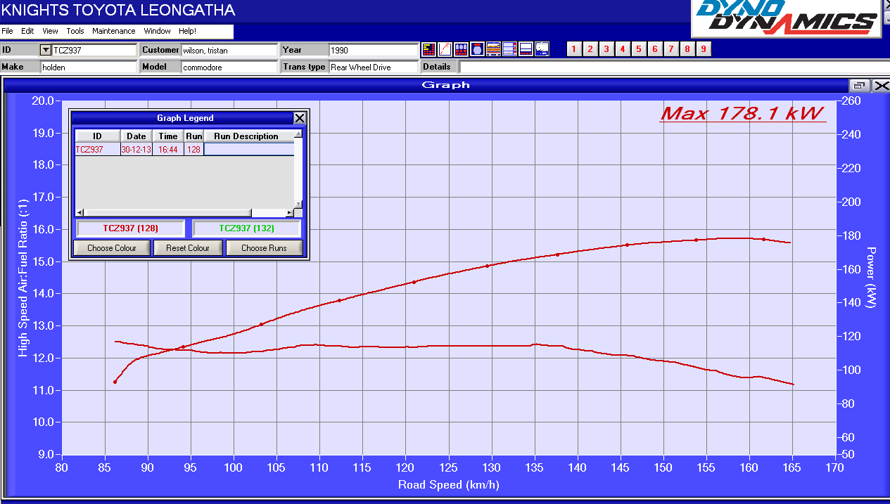

had a good run on dyno tonight added some more fuel and timing, now running 23degrees at WOT, ambient was around 27 degrees. have updated bin file again.
