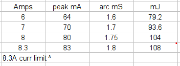

Holden202T wrote:I'd be very interested to see the test results of an LS1 coil compared to the above info!!
This kind of coil -> http://www.knology.net/~rv7rotary/13_1_b.JPG
Same 1700 volt zener load string.
Internal coil driver limited at 8.3 amps.
Results:-
