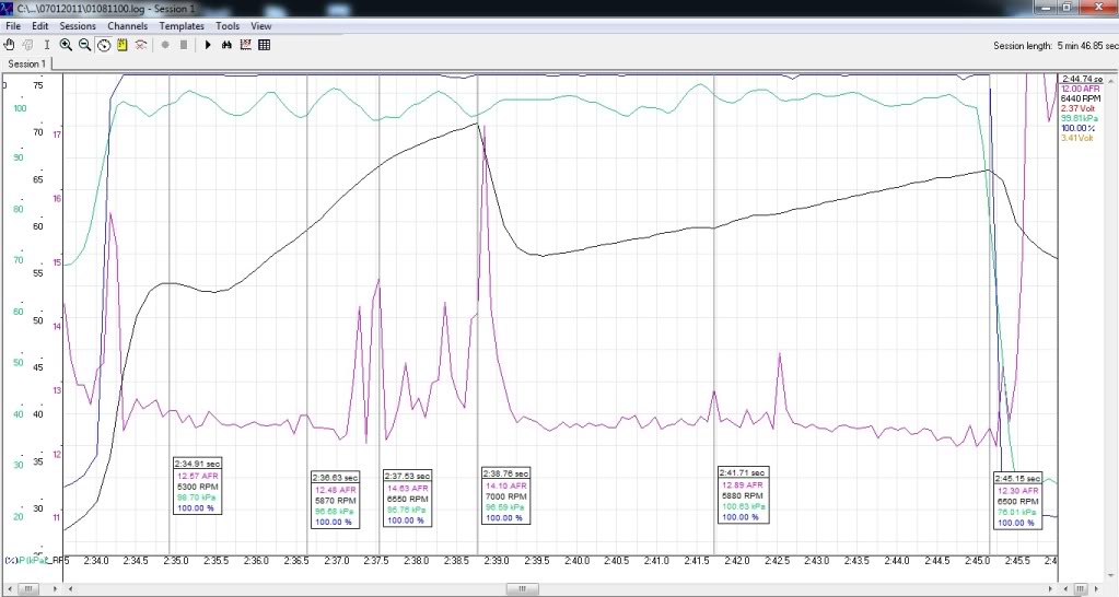

Basic setup is a chrysler reluctor dizzy. Delco ECU feeds a camira ign module which passes the output to a MSD 6AL-2 and MSD HVC-2 coil. Spark output should be more than ample for this motor. It is not always as bad as this log either, the 10.30 run was cleaner. The LM2 RPM input is taken from the distributor ref signal - camira module feeding the delco - and looks pretty clean. And as can be seen, in 1st gear it misses at a bit before 6500RPM but crosses the line in top at 6500RPM with no misfire.
Anyone got some ideas??

almost looks like a fuel surge issue is that possible with the setup thats on it
looks like its leaning out before the acceleration falls off
if the leads are still paired id seperate them as if had induction issues with leads before and can be hard to pinpoint
also maybe close plug gaps to 30 thou
looks like the afr graph is wavy due to map pressure fluctuation id look at modifying trumpets for better flow and changing the air scoop on the bonnet as this could cause the pressure beffeting seen on the map log

just looking at the graph again every time it goes over 105kpa on the graph just after that you get the "misfire" leanness as shown in the afr log
id say its spark by the look of it or you need to fatten up the fuel table to make the mix burn with the higher map pressure
might be a glitch making it lean out over 105kpa with the 1 bar setup?????? nfi lol
could be a spark problem with a lead or as said seperate leads from their pairs or maybe coil or the firewall plug could be leaking current

Fuel surge could be an issue, although tank was nearly full (20L with some internal baffeling and lowered pickup. Fuel pump is a bosch 044 and lower than the pickup point). We dont run a surge tank, has been like this for a number of seasons and never had an issue although its now a fair bit quicker. I do have a surge tank and we have the old BG 400 pump from the carb days so could try that fairly easily. Might actually add a fuel pressure monitor for the next meet, have been meaning to so prob a good time :thumbup:

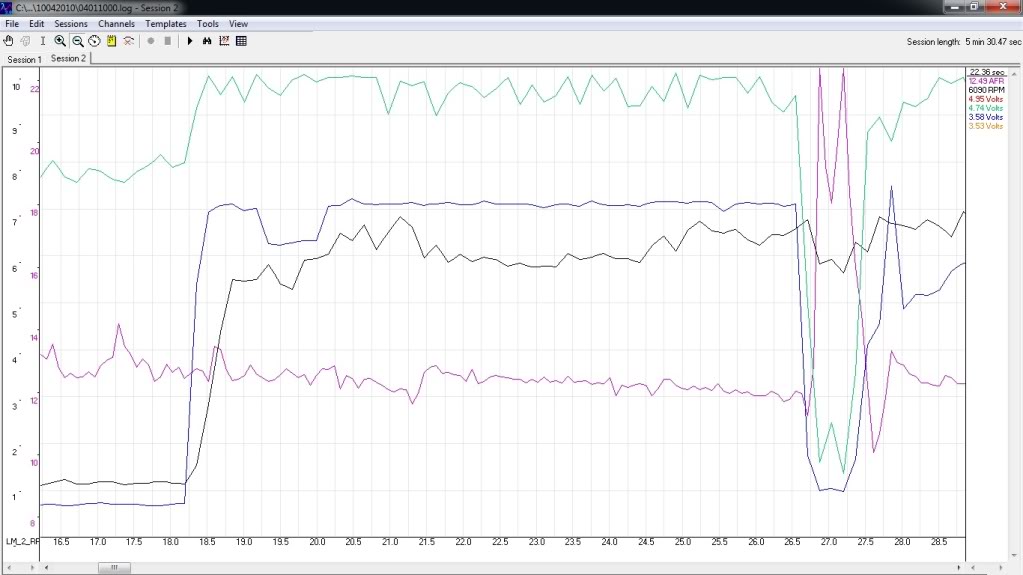

The unfiltered MAP signal ranges from 93-103kPa which is not real good - it used to be really stable but lots has changed since then. Although the LM2 is crap when it comes to getting reliable signal levels so will get a TP5 log and compare. The intake is not sealed against the bonnet scoop so the airflow is all over the place!! This log was before the latest firmware update, nothing has changed with our setup and check out the totally unusable RPM signal (black trace) and noisy other channels but no misfire ...
The leads are paired up and was one thing we thought of changing but didnt get another run :( The other thing we will check more carefully is the dizzy rotor lining up with the post at 34deg advance, never checked that since converting it to EFI. Not sure what plug gap is either, will check that one.
