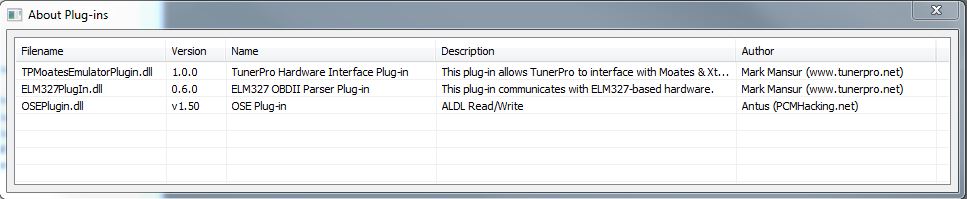

it shows the file in the correct place? but unable to select from the drop down, can't select it in the emulation drop down either.

Sorry if im not getting this, but it is...
the address looks like - Libraries, Documents, Tunerpro files, Plugins,
in the video it is the second from the bottom - OSEPlugin.dll

The location you have it is fine, and is the correct spot (tuner pro app dir location is depricated) what does your anti virus software have to say about it? Perhaps a false positive and not letting it load?

I even updated to the latest tunerpro and downloaded the latest OSE plugin. my plugin file is in the same location as yours and im running win7 64 bit with microsoft security essentials... mine loads fine.
might be a long shot but maybe try checking ntfs permissions? perhaps some weird permission got applied to that file and wont let tunerpro load it? also are you using the latest versions of both tunerpro and plugin?Re: connection errors with TP
