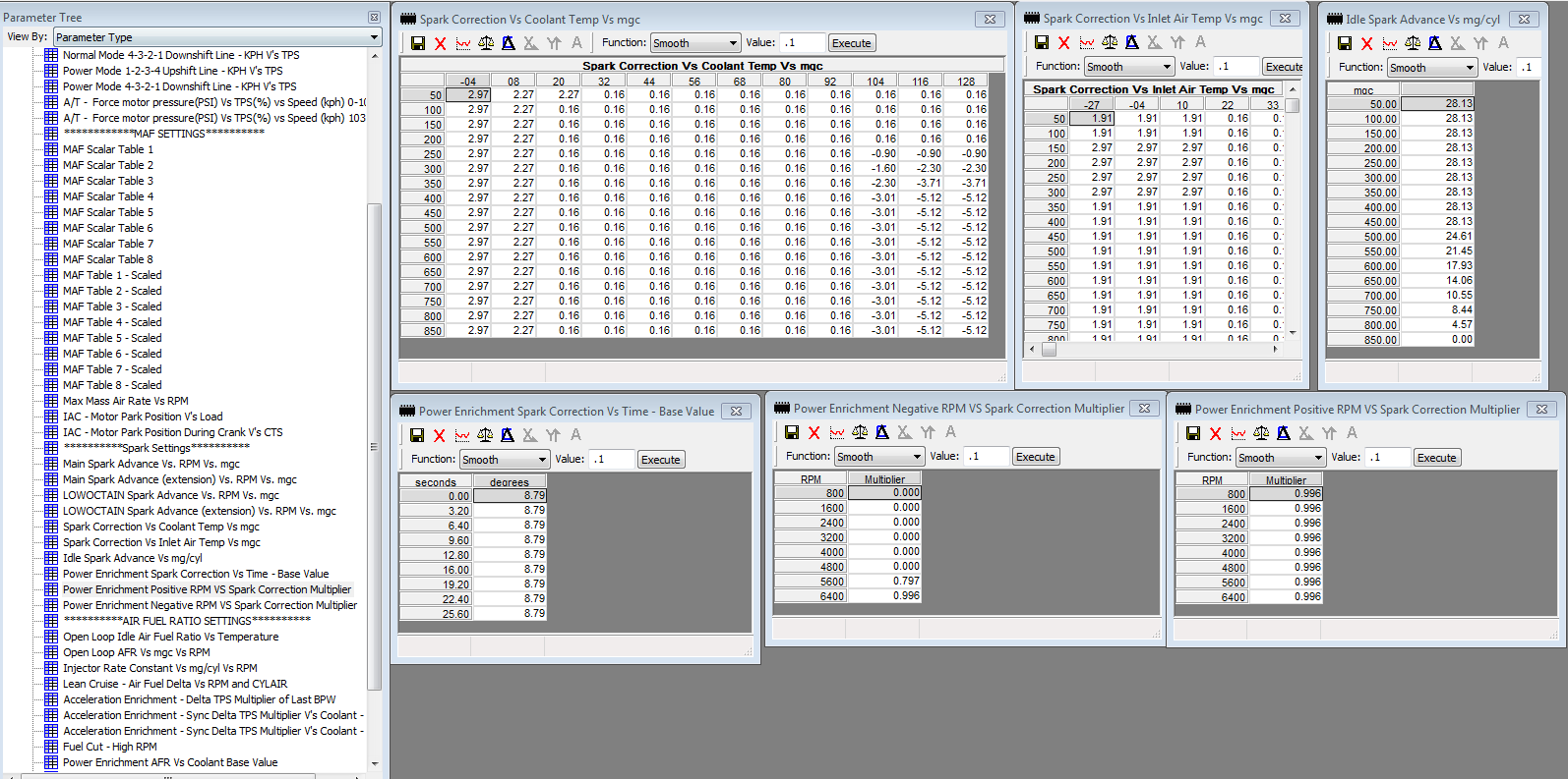

Picture of requested chart, but still trying to work out how to attach whole log .xdl.

just looking at the part of the log you posted, looks like you are right, there is some knock happening down at low rpm, you can try removing some timing from there to stop it. in the log, you should see an item called, "milligrams per second per cylinder" that is the horizonal axis of the spark advance table. you can use that to match up to the RPM and MGC of the advance table to find the exact cells you need to lower.
There is still the possibility that it is false knock and the noise you and the knock sensor are hearing is just a noisy valve train. Ive found big cams have a tendency to trigger false knock. If you lower the timing heaps and the knock doesnt go away then it is most likely false knock and you need to be adding ignore knock counts at that rpm

I've been having a play with various bins and stuff since I got home from work, and it seems most of the tunes don't start taking spark out until 350 mgc or more. Is the lowoctain spark table the one the ecu looks at when it detects knock and retards the spark, and then switches back to the main table when the knock stops?? And then there's half a dozen more "variables" charts that I don't fully understand yet, but it's a work in progress.

The low and high octane maps are blended between each other. The more knock that happens the more the low octane table is used, it slowly returns back to the high octane if there has been no knock. Some more info here .. http://pcmhacking.net/forums/viewtopic. ... ane#p36111
The link explains the blending of the high and low tables as you were asking how the tables are used, its got nothing to do with the tables in your latest picture. Most XDFs probably do not have the adaptive spark defined, but just keep it in mind as to what is happening behind the scenes when your logging.
